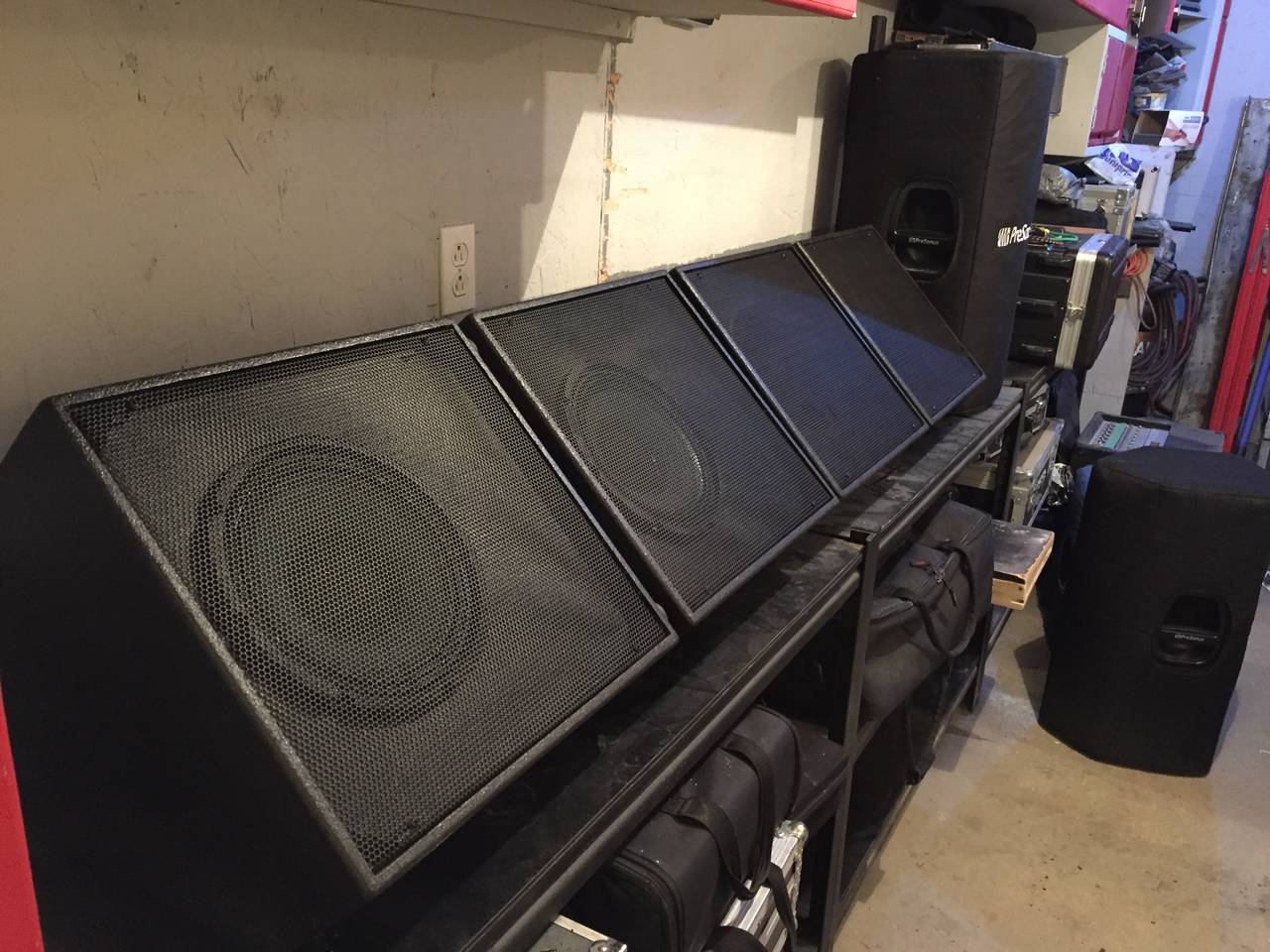

I already have Presonus AI 328’s for FOH but I’d like much smaller speakers for delays. I also have built 4 Simplex 10 wedges and have two more on the way....very happy with those btw I should really do a build review I’ll try to get to that soon and do my part. I have used those wedges on stands as delays and they sound great but they’re still a bit big for my use. I am a musician and not a wood worker by any means but they turned out well for my first project so thought I’d try SLA’s for a slightly more difficult project that better suits my needs.
