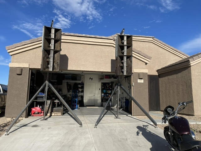

I just completed a pair of Tlah speakers. I also have a small line array configuration of Omnitop12 cabs, see attached photos. I was able to build my Tlah speakers for super cheap using buyout speakers. I have under $300 invested and that includes the filter components, speakers, wood, glue, stain, wire, etc.
I have been on this forum a while now, I haven’t found a better product if you are into DIY. You will have to easily spend $1500 or more to buy commercially available speakers as good or better than a properly built Tlah. Are there better speakers out there I am sure there must be. There are a lot of the products such as GR Research selling flashy snake oil? Yes, they are. Sound, like many things in physics, is logarithmic, in that the point of diminishing return occurs pretty early on and the difference between a $10k and $100k home theater system is very little.
If you have a certain demographic to impress or just have millions of dollars burning a hole in your pocket by all means buy or build whatever you want. If you are on a budget I see no better speaker option today than the Tlah. It is transmission line, line array, pretty small form factor and cheaper than any other option I have ever seen. They are pretty easy to build. They are awesome, I wish I had designed them!

Looking at your OTop arrays made me think of something. If a line needs to be almost floor to ceiling to work without severe lobing and cancellation problems how do they work outdoors? :bash:
Nice stands, BTW. :hyper:
