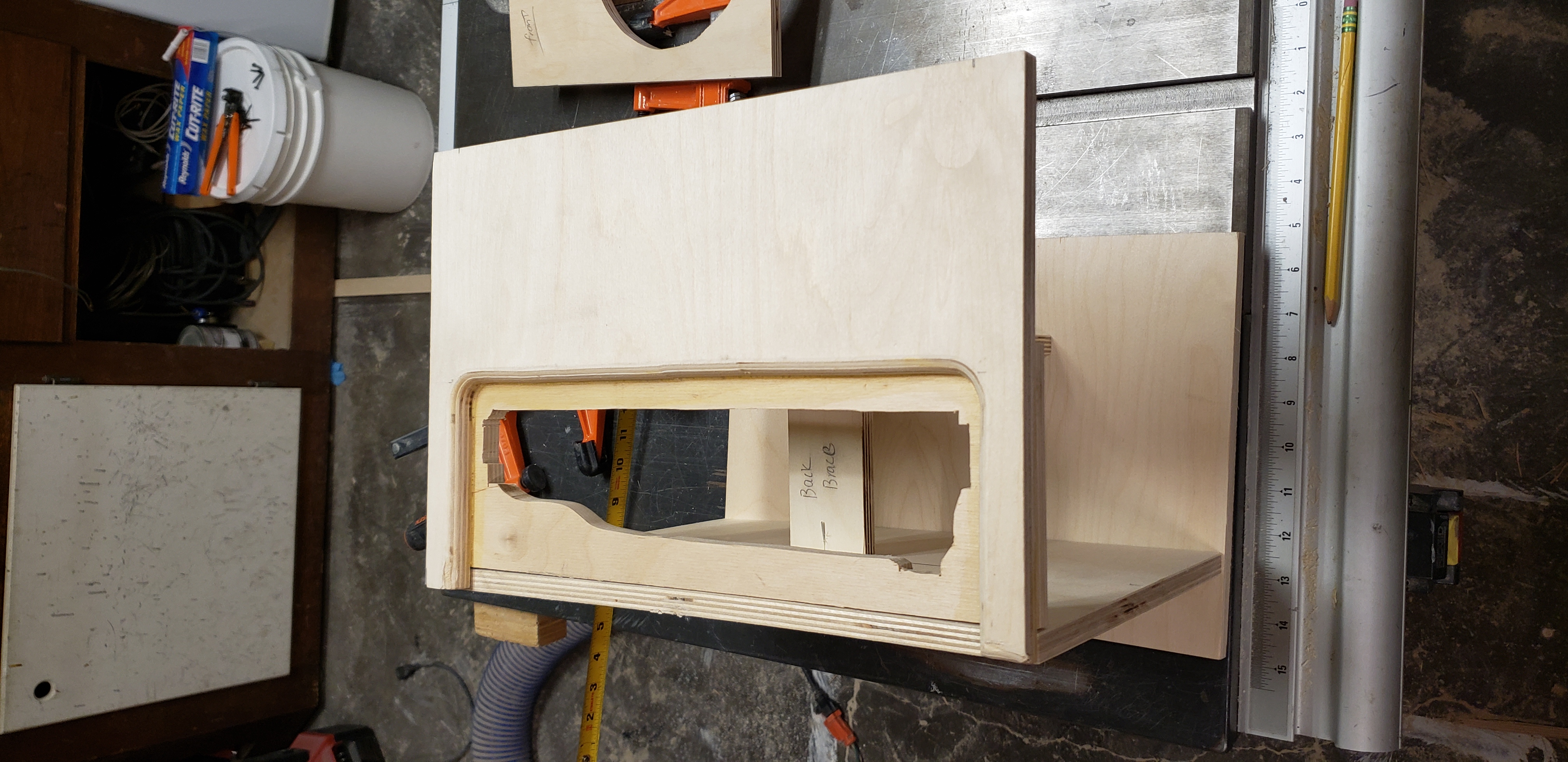

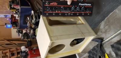

This isn't going to be much of a build thread but I told myself I was going to post this here so, here we go... :noob:
I ordered the parts on a Parts Express buyout special about 8 or 9 months ago, and am just now getting around to putting this together.
They still have the little 5w "footnote" amp for around $10-15, but I can't find the little 6.5" Eminence guitar speakers anymore. As tested, Alpha 6 drivers would work well too.
As stated in the title, this based off the 2×6 SLA PRO plans.

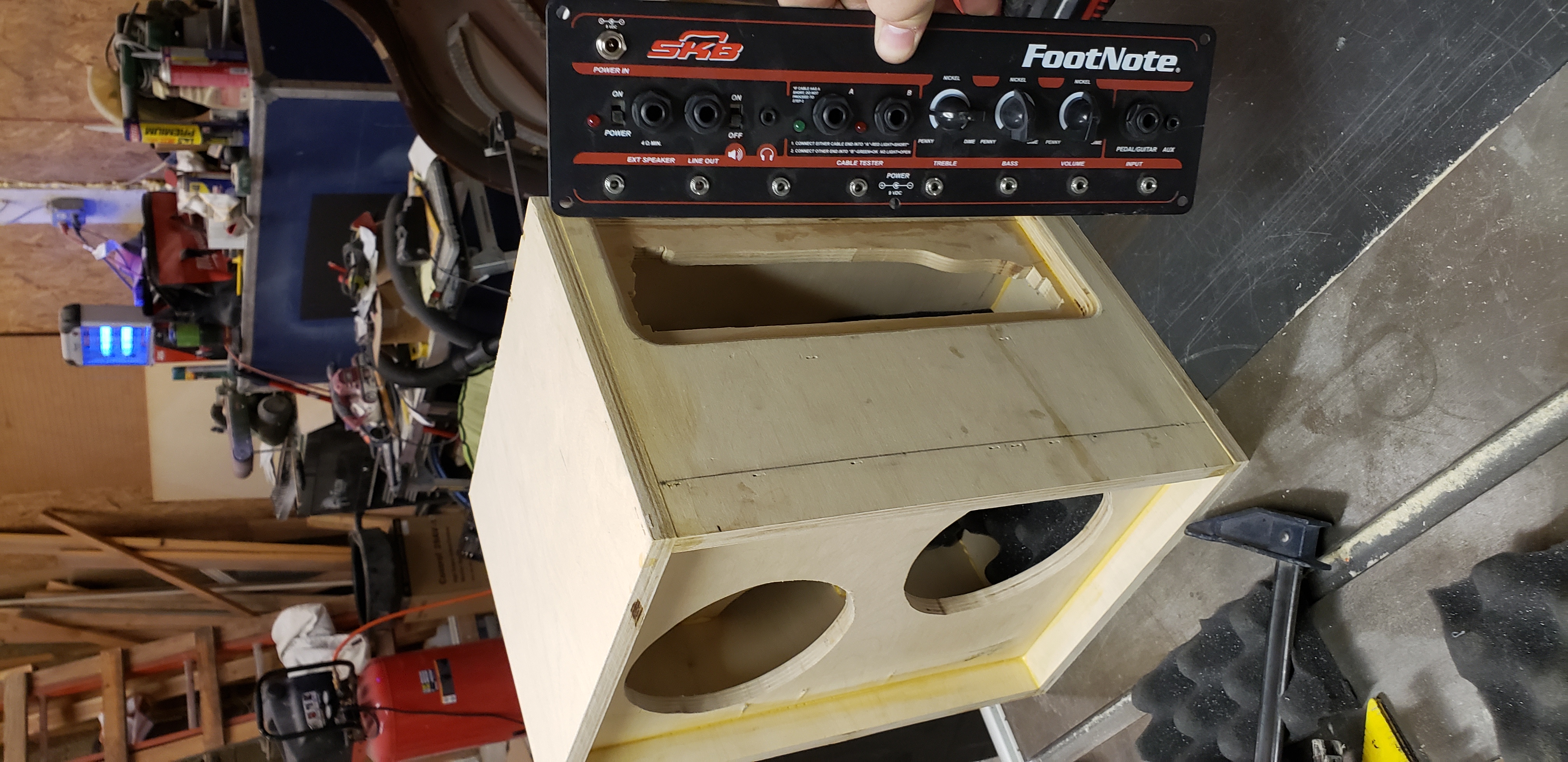

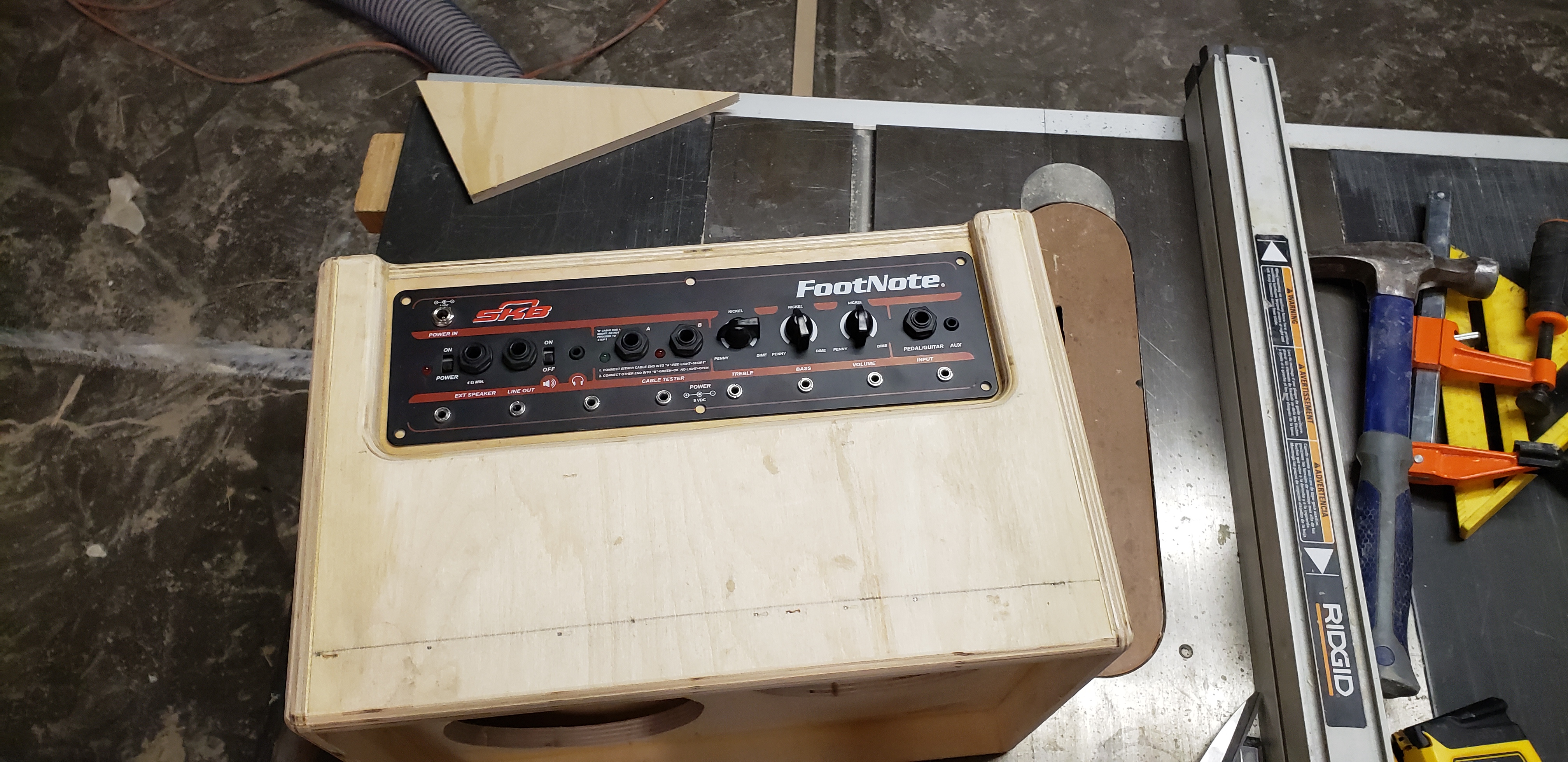

Main differences, no port, no tweeters, no X-over, oh and there is an amp shoved in the side.

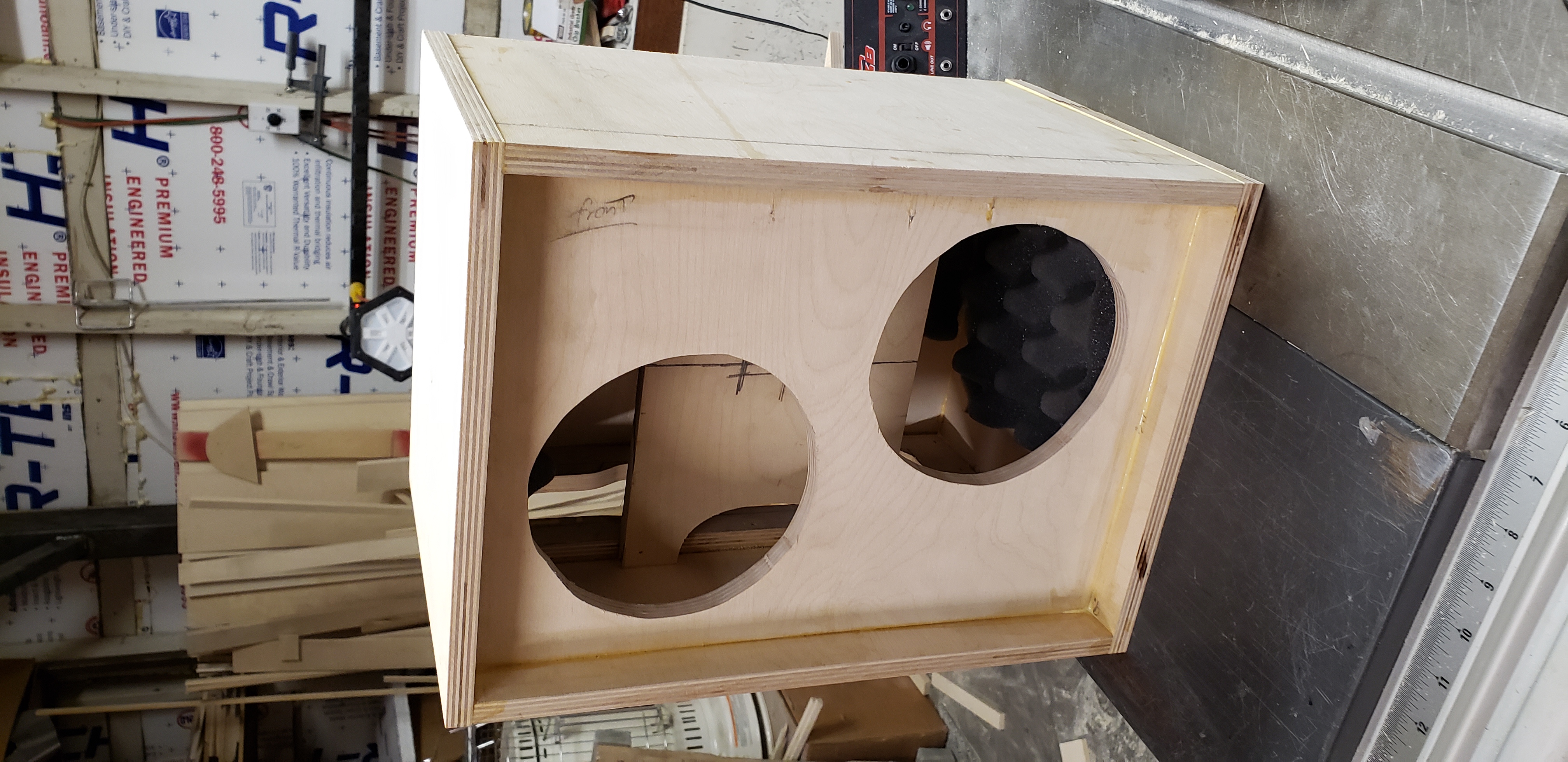

The hardest part was the roundover around where the amp is recessed on the side. The bering on my roundover bit is too deep to route after the cab was completed so I clamped the side piece to the edge of my work bench and gave it shot.
I guess as to be expected, it didn't come out that great and took a fair bit of sanding to get it back to shape.
I forget who said it but. " A sander and Paint make the woodworker I ain't" :)

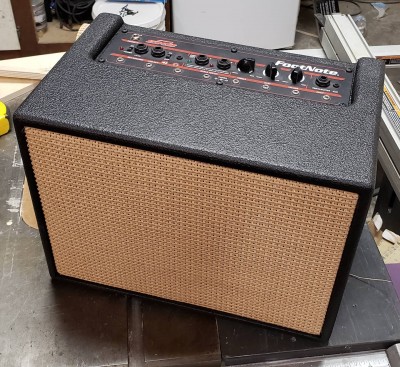

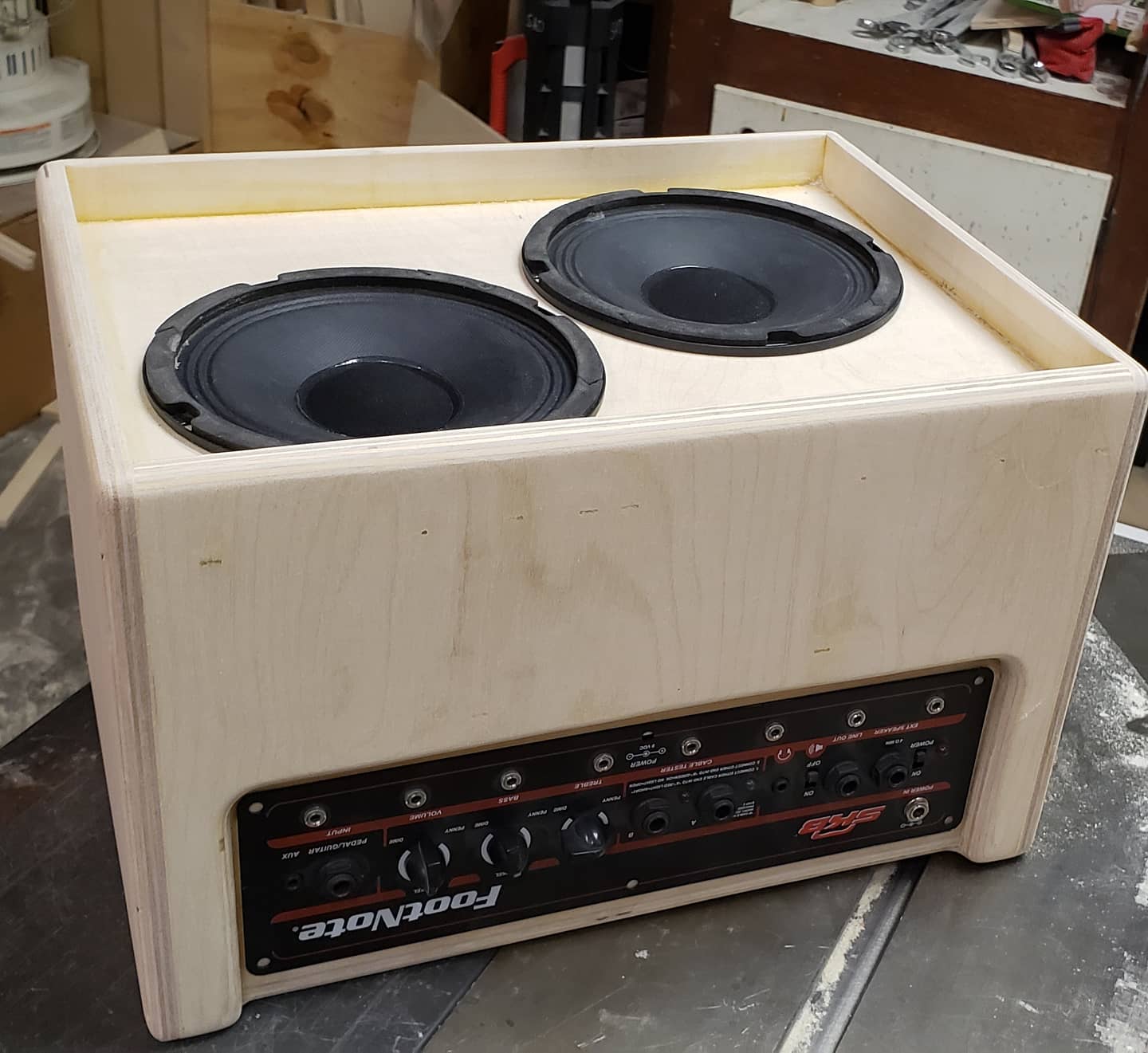

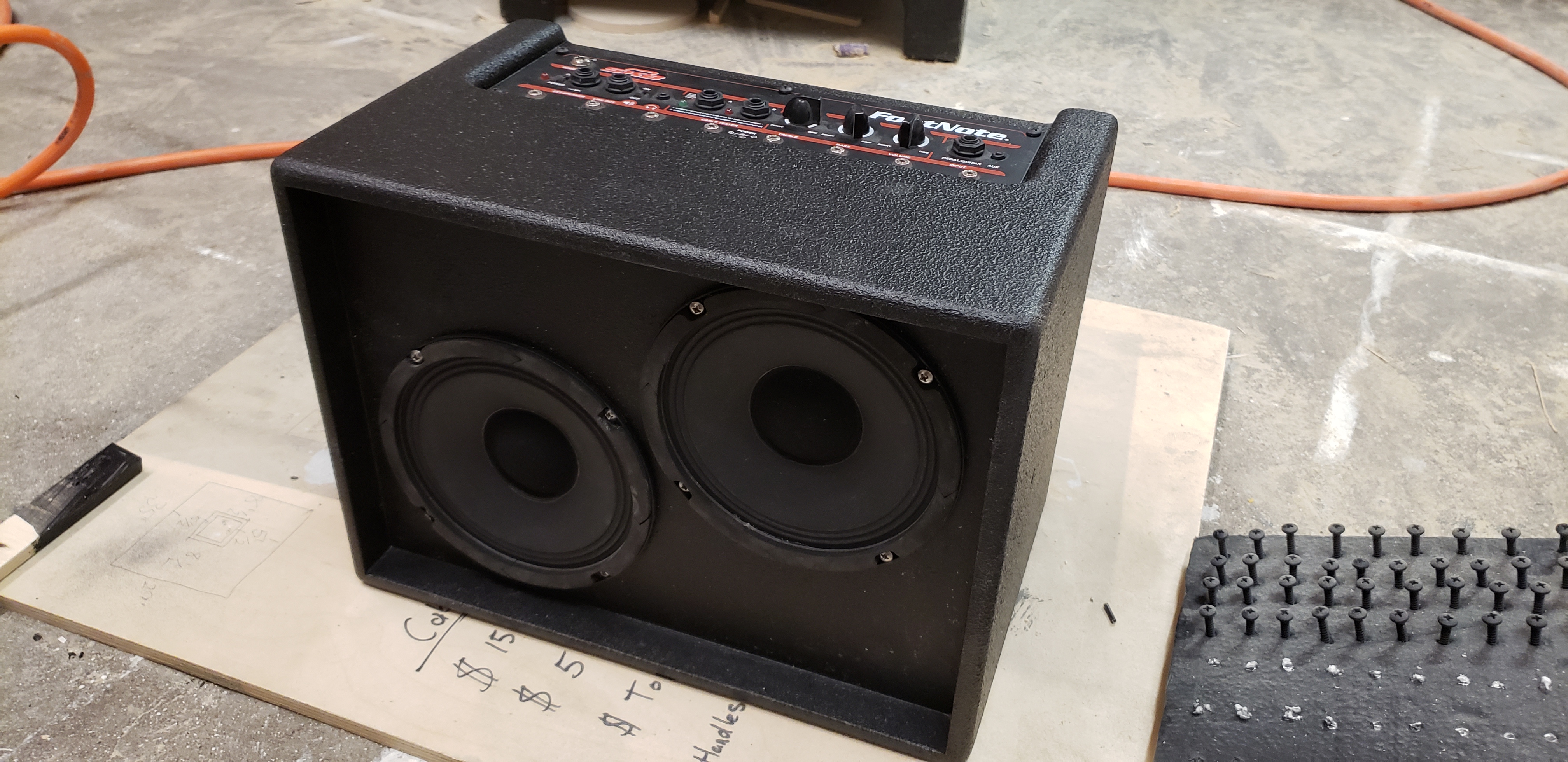

The mini SLA pros take so little wood I was able to make the whole project out of my pile of scraps ( it is a big pile though..)

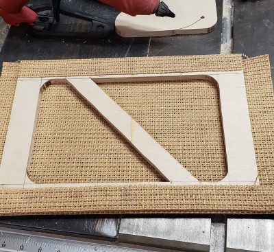

The grill cloth was left over from a recent XF212 build.
For some reason both of my staple guns have gone missing so I ended up hot-glueing the fabric to the frame. It actually worked well, but I would still recommend staples if you have any.
The drivers are offset just for the fun of it...
Its pretty much done at this point, I just need to order a handle, add feet, and find someone to 3d print me a cool logo for the front.
I haven't tested it yet in its final form yet. I'm waiting on a new power supply.... :bash:
But I remember testing it when I first got the parts back in the day with a built to spec 2×6 SLA and I like the results.
If I miss the ports on the combo, I can always add them back latter.
That's all for now.
