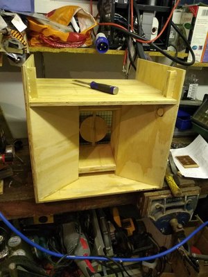

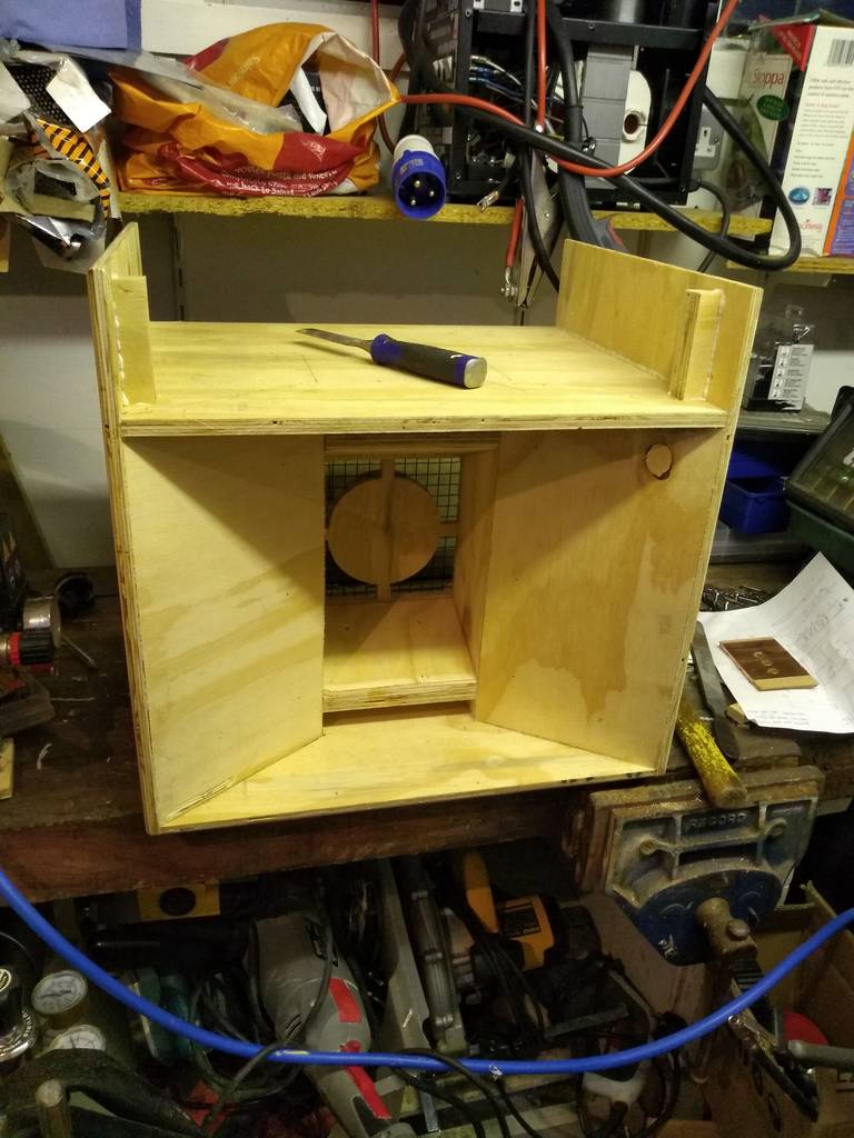

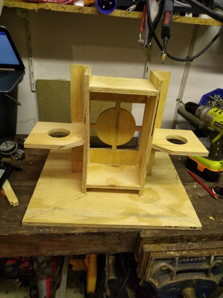

This is my build so far. I've actually mostly completed the Airhead Jack 10, and am trialing drivers.
Bill's plans are great. The writing is a model of economy. Everything important, nothing superfluous.
Note to self: clean up your shed.

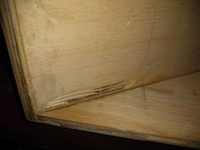

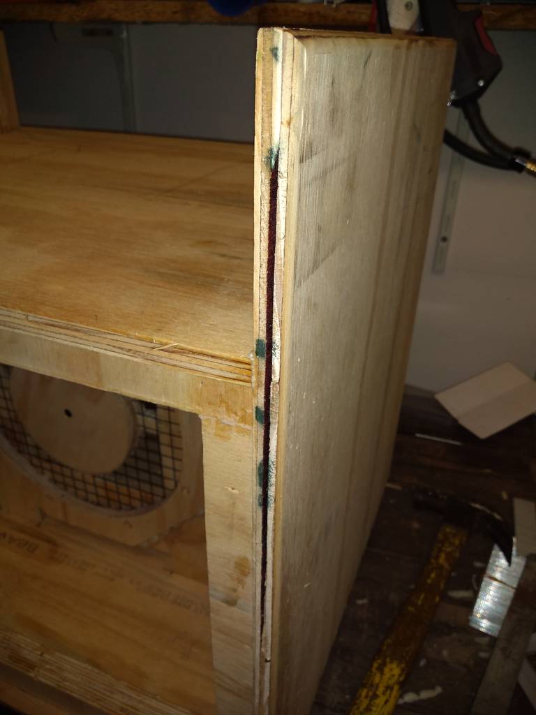

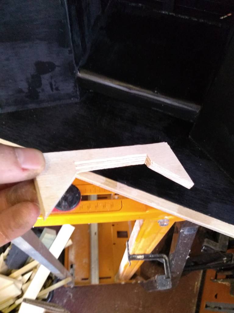

My first time using expanding polyurethane adhesive, haven't quite got it down. Check the squeezeout!
This is what happens when you don't remove the jig quickly enough.

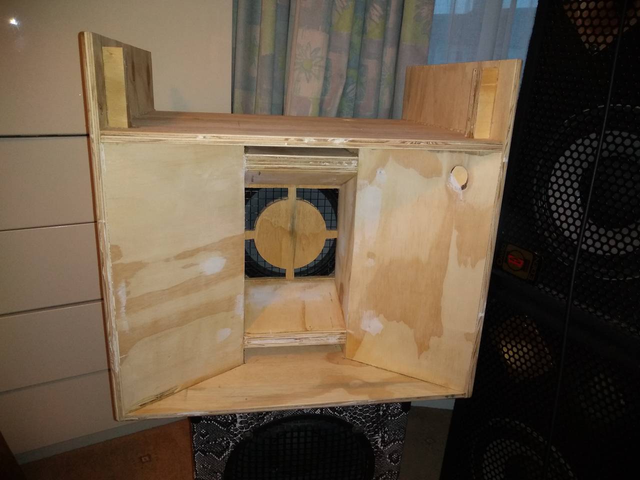

For this build, I used some cheap pine decking ply from a DIY shed I had lying about. Yes, I read and understood Bill's comments on plywood.
The quality is shocking, as you can see. Some of the voids go the entire length of the sheet. Some big knots, but they seem tightly filled with some plastic filler that will not finish well.
I avoided the worst of it, and filled the voids (at least the exposed edges) with auto body filler. We'll see if it rattles or refuses to hold screws.
In spite of that, it went together quite well and feels unbelievably stiff.
My subsequent builds will use higher quality Baltic birch or Italian poplar, probably.
Sealed up now, I'm trialling drivers. No tweeters yet, I'm seeing how it sounds without first.
Very exciting. First impressions:
- Very loud, very efficient.
- Bill's advice on the effect of wall and floor on bass response is spot on. The difference between mid-room on a chair and on the floor near a wall is astonishing.
More later. Comments and advice are most welcome.

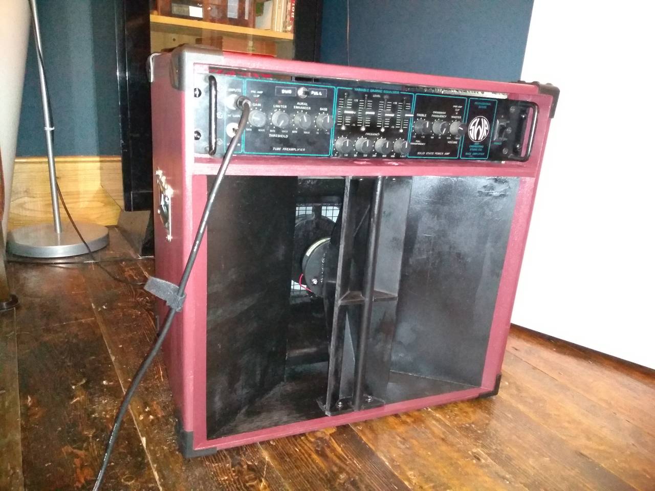

I've finished my first Jack 10 Airhead.
I've not yet leak tested, nor checked the HF driver polarity. Just put it in the corner of my lounge and whacked my bass through it.
I started this as a trial using up some nasty 12mm decking ply and an old 10 inch driver that I had knocking about.
This is not a recommended approach, Bill's specified drivers and materials are there for good reasons.
Nonetheless, it turned out remarkably well. So loud!
The cabinet was made exactly to plan, with a few small alterations:
- I went ahead and blindly used Bill's measurements for the 2u space above the speaker without measuring my amp first.
My amp has feet, and requires a little passive cooling space above it. So I made the top oversized and put it on top of the sides rather than between the sides as the plan dictates. This gained me the required 1/2 inch extra.
- I don't know what I'm doing, but the substantial weight of the HF driver on the back of the shop-made horn makes me a little nervous. I've had roadies sheer the magnets off the back of woofers by dropping cabinets off the back of a truck. So I made these little cleats to nail and glue behind the horn ends. I then bolted the horn into the cabinet with tee nuts.
