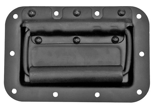

yes i will,
i cant buy easily and quick the same handles as the plans, they seem smaller than all i can get, can i use theses instead?
The ones i see at stores in canada are bigger and i fear they will cause problem because of the thigh space with the inside braces.

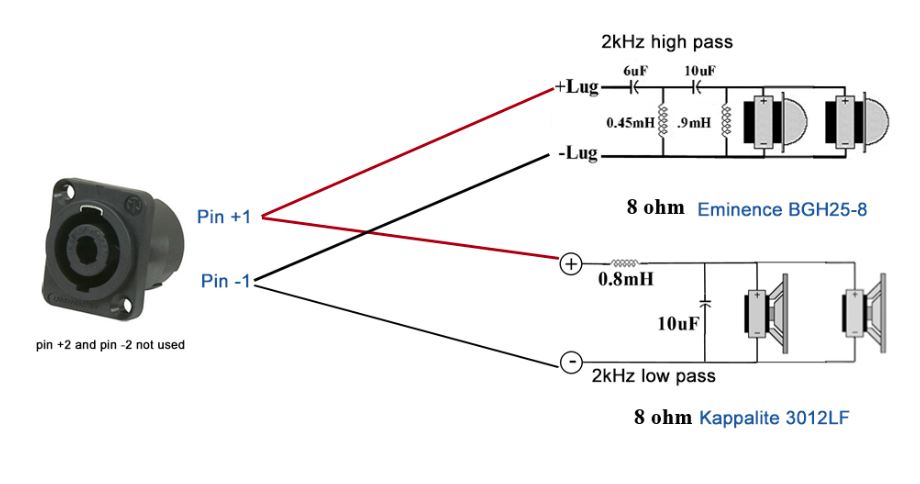

So i made this, just wondering if any one can confirm it's good? Please please? haha
If i check the 3d plan they are in parallel, both woofers in parallel, in parallel with the tweeters that are also in parallel, that makes a 8ohm cab ? 8+8 ohm in parallel is 4ohm but i'm not sure how it works with the crossover and the 2 speakon connectors also in parallel
I would think woofers would be in series to get 16 ohm, tweeters too at 16 ohm in series, then tweeters with woofers in parallel to end up at 8ohm?
Not quite. Since you are planning to parallel wire the drivers, you need to count them as 4 ohm....each set will be 4 ohm.

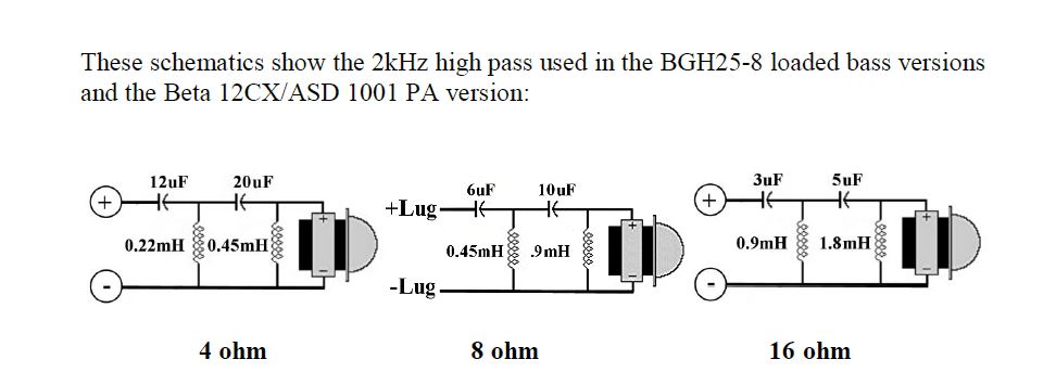

What represent exactly the 4,8,16 ohm title under each tweeter crossovers?
I have to choose the middle one for the tweeter and woofer that i use (which are 8ohm each) ? or does it refer to the cabinet total impedence with the used wiring setup?
Or... since i will wire the 2 tweeters in parallel that makes 4 ohm so i must use the left diagram for the crossover for the tweeters? then same concept for the woofers?
