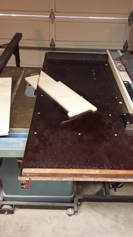

I finally got some time to work on the horn pieces today. I made a jig very similar to bman's, except I slid mine against the fence to the right of the blade. I did make a minor error cutting these bevels at 13 degrees instead of 11 (I didn't change the blade after beveling the bottom edge) but that error seems small enough that PL will take care of it. (2 degrees across half an inch is just over 1/64th). Now I'm thinking about good ways to make the large rectangular holes in the throat horn supports.
First I made the angle cut along the long side of the throat sides: Next I made the first compound cut: The brad nailer really made assembling the jig easy, once I got the angle right.
My picture of the second compound cut didn't come out.
The second bevel was against the fence.
I also beveled the throat horn supports, and then set all of the pieces together: Once I cut the rectangular holes, I can glue and brad everything together.

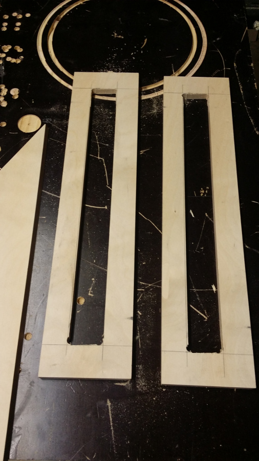

Any advice on the large rectangular holes? I figure if I can get one just right I can use my pattern bit in the router to copy it. Perhaps a rising table saw cut for the long sides and some jig saw work.

Honestly, you would need to make a template and cut the rectangles off that.billkatz wrote: Any advice on the large rectangular holes? I figure if I can get one just right I can use my pattern bit in the router to copy it. Perhaps a rising table saw cut for the long sides and some jig saw work.
Worthwhile perhaps if you intend to make more cabs, but in the similar amount of time to making a template, you could have marked up all 4 rectangles, drilled 4 x 1/2" holes in each corner, and cut them out with a jigsaw.
Also, because of the shape of the rear of the horn, you can't put both horns face to face meaning you could cut two rectangles at a time.
Just right? No one will ever see them, except for the pics you may post up here on the forum...

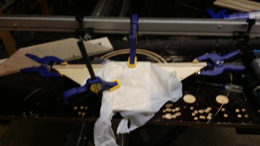

I took Grant's advice that the holes don't need to be perfect, and set about cutting them. I drilled 4 corner holes, and cut the long sides of the first one with a plunge cut on my 18V circular saw. It was OK, but not as straight as I wanted. I cut the long sides of the next one with a rising table saw cut. This worked very well, and I used it for the remaining cuts. With a calibrated fence the cuts went quickly.
Then I finished the cuts at each end with my jig saw, cutting the ends of the long cuts and the short cuts. You can see the cuts are not perfect as they meet the holes, but I hope this is good enough for these inside holes.

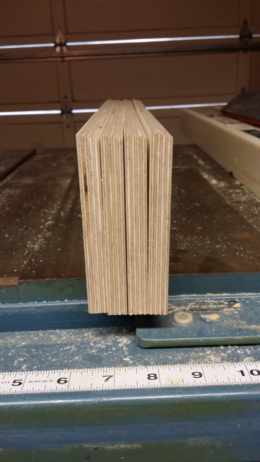

Next I glued the horn sides to the horn supports. I tried drilling a jig as in the plans, and it seemed like more work than needed. I reverted to using a jig, but with a clamp, and then clamping the side with 4 other clamps - just long enough to shoot some brads along the seam. While the brad gun made some things on the titans easier, this is where it really shines! I had things clamped up, shot the brads, and was immediately able to take the clamps off and use them on the next assembly.
Now I have 4 pairs of horn sides and horn supports glued up and drying:
I'll give them a couple hours, trim the PL, and let them set overnight. Perhaps Friday I'll finish these assemblies, and start work on the baffles.

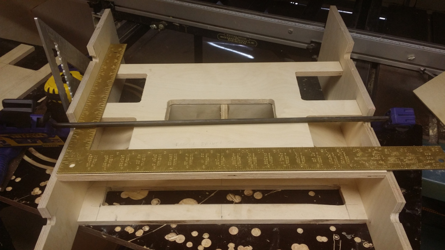

I made some progress this weekend. I squared up the horns, and tacked in the center support: Then I put the remaining ends on, and cut the angles at the top and bottom of the assembly after the glue set up.
Then I started working on a pattern/jig for the two 4" square holes at the top and bottom of each baffle. Since there were 8 identical cutouts to be made, and I can see the the audience here likes things tidy I decided to make a pattern so that I can rough out the cuts in the baffle and then make them pretty with my router. What's the point of investing in a nice router if I don't use it?
I made more progress today as I stopped off at the plywood store and picked up another 1/2" sheet which should be enough to finish the cabs. They didn't have 1/8" Russian Birch, so I went for the backup Italian Poplar for the 3 ply, 1/8" material. I made the first cuts in that sheet so I could get the pieces down to a size where I could lay them flat so that they didn't curve prematurely. I was careful to lay everything out with the correct bend direction. (my supplier actually has both 4x8 and 8x4 sheets so you can choose your bend direction relative to the sheet dimensions)
Now I have to finish those baffles and lay out the top and bottom.
And this point I can appreciate the simplicity of OT12s. The amount of work I put into the 4 horn sides and the baffle would just about finish an OT, while the DR has a bunch of work. But with the 1/8" material in hand, it definitely feels doable.
I'm thinking about short sides with the rounded backs showing, but I'm now wondering if the poplar is too soft for that.

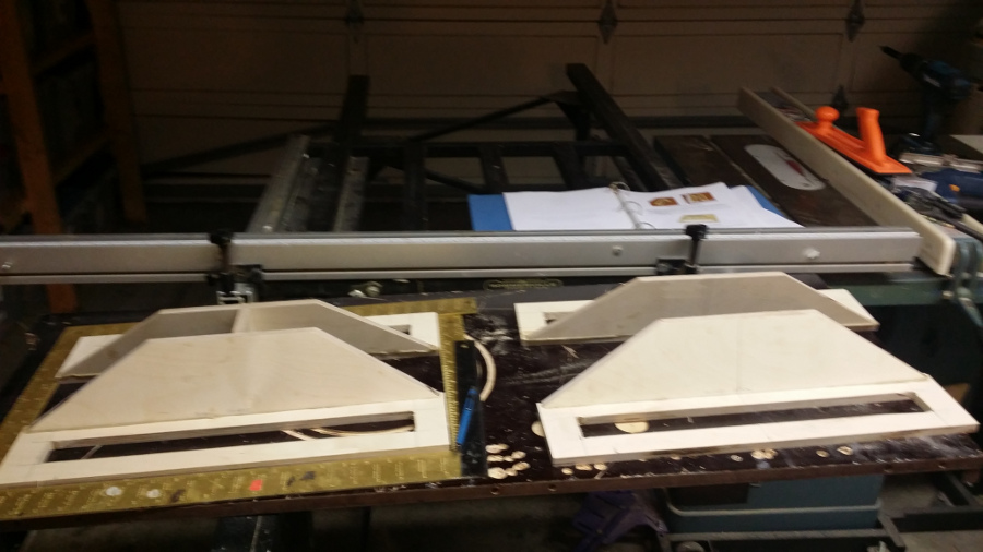

I finished the baffles, using a template and router for the 4 larger openings on each, and a circular saw and jigsaw, and being very careful for the central opening. I used some scrap pieces to alight the horn front and the baffle - thee 3 degree cuts lining up perfectly.
Here is the horn all clamped up:
Both horns are finished, save for the woofer spacers, which I can't complete until I order the woofers. Next task - lay out the design on the top and bottom of the cabinets, and fabricate the horn sheath braces. I can see how getting the horn sheaths on will really be a huge step toward making it look like a speaker cabinet!
