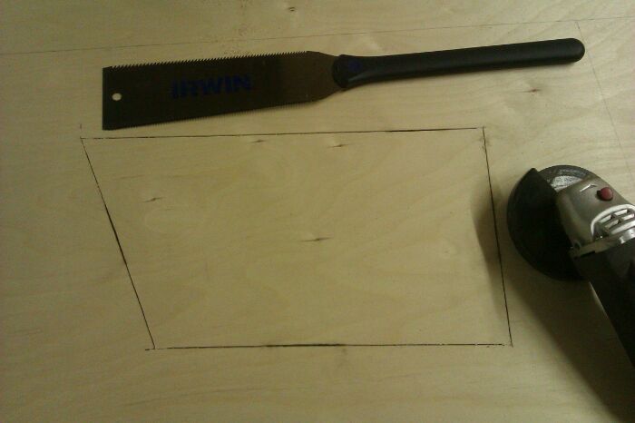

My Dad wanted to prove out a neat access cover hole cutting method. A 0.8mm thick (actually thin) steel-cutting angle grinder blade and Japanese pull saw.

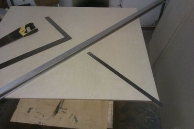

We went on holiday to Barmouth (Wales) from Friday to Tuesday, so progress has been slow. Had a good sesh last night. Am still cutting up wood. There's a hell of a lot of sawing. I know one is supposed to only cut pieces when required, to limit warping, but it's nigh on impossible to do. I need the 'bench' to saw plywood on and assemble one of the cabs so I need to practically cut everything up (except angle trim cuts) including the braces, before I start assembly. While I'm on cutting up; pieces 5 and 6 are listed as a rough length of 16" long - piece 5 is a good 3" less than that!
The main interesting thing last night, apart from sawing 46 linear foot of 12mm plywood by hand, was setting out the V plate (piccy below). I've seen one post about someone having difficulty with this. The way I did it was to measure (and mark off the length) down the sides of the wood from the square corner first. Then mark a short square line off at each of these two positions. Then mark off a 45 degree construction line from the square corner (where the ruler is!) - use 'pythagoras' to get this bob on. Then put your framing square on this line and move it away/closer to the square plywood corner until it crosses the short square lines (struck from the sides) at HALF the hypotenuse value given in the V-plate drawing. Strike that hypotenuse all the way across. Badda bing! V-plate happiness!

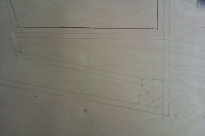

Here's a question. I got to drawing the restriction part indicated with 2 lines of equal length, approx 45mm long. Without the gusset (as per the plans), the 3rd line would be about 70mm to the internal corner, but with the gusset that I've drawn it maintains the approximate 45mm wide path. Is there a theoretically optimum shape here?

So, in the picture; is this a region of pressure rather than flow, so cancellation mitigation is not required?

#15 Post by Chris_Allen » Mon Aug 26, 2013 4:29 am
I've questioned this before and Bill said that's how it should be. Didn't explain why.
