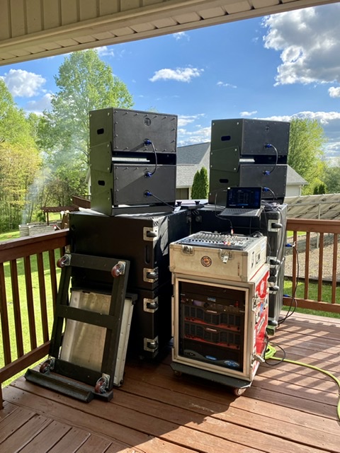

Pulled the rig out for a graduation party today. Sounded phenomenal for hours right up to the last tune, at which point my amp running the otops blew. Like sparks and all. Will be interesting to pull it apart and see what happened, since I still wasn’t even into the limiters, tops or subs.

You know, the first thing that I think of is high frequency oscillations. Are the 4 ohm resistors in good shape, and power has to run through them...not bypass? Is the setup in the photo the way it was run? If yes, were high frequencies boosted?

Yep, the Crown CH is what I run the tops with. Two CEs bridged to each run a pair of subs. Pulled the CH out of the rack and replaced with an identical spare amp
. Opened up the blown one expecting to see something burned or popped, but everything looks fine. Based on where I saw it spark, maybe it was the board that has the clip and protect lights? I'll have to see if our local repair shop is even still around - I think they might have shut their doors during the pandemic.
