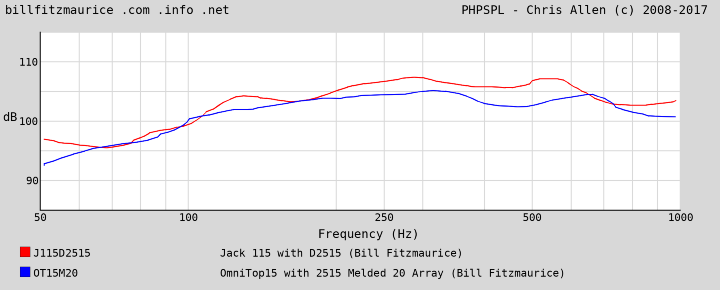

Between the OmniTop 15 and the Jack 15, which has the lowest distortion at low and high output levels? I will be running the cab from 100Hz up to 700Hz and using dsp to crossover. Ultimate output is not really an issue as they looked very close on the SPL charts here on the forum.

If you're only using them above 100Hz build the OTop, it has better midrange and the box is smaller. The main difference between the J15 and OTop 15 is that the larger box size of the J15 allows larger port area, to prevent low frequency chuffing. Since the OTop 15 is intended for use with subs low frequency port chuffing isn't a concern. Distortion isn't a factor, either is cleaner than any direct radiating 115. As to why you're only running them to 700Hz, I can't think of a logical reason for that.
