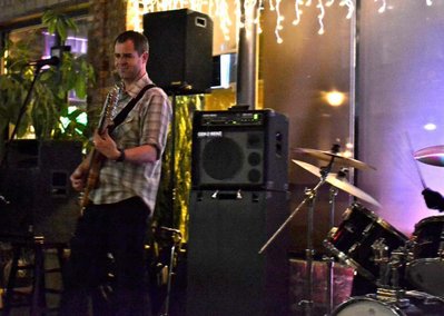

Here's an option that I chose: Use a cabinet designed for bass, and supplement it with a titan39. The plans include how to make a passive crossover that includes a high-pass out for a top. You can see the input/output jacks on the top front of the titan. I run the output of the amp into the crossover on the left, and take the signal from the output on the right to the bass cabinet's speaker. With my small gigs and practices, usually the combo amp is enough. I don't know if a Otop12 can be used as a bass cab by itself.
BASS: Combo Amp & Titan39
