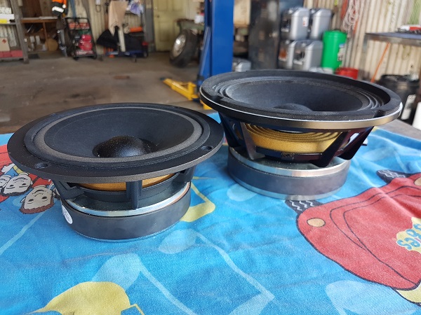

Gday, going to give these a go for a 4x6inch SLAP pair, and 8x8inch TLAP pair, avaiable from VFM Audio in Brisbane, a bit down on power, but are reasonably priced, especially when you buy them all at the same time, ended up costing $36ea as the 8's were on special.
Specs:
https://www.vfmaudio.com.au/13921/FS-Au ... -160-Watt/
https://www.vfmaudio.com.au/19776/FS-Au ... tt-Woofer/
Just waiting to build 1016 arrays when the tweeters turn up, they are a little deeper than the Eminence, and the 6's have a larger frame size, I've had to make the SLA longer and wider plus move the main brace back to fit.
I know backmounting the 8's in the TLA is not the best, but to mount these securely it is, there's no room for a decent fastener coming in from the front face.

I know the all important Xmax spec is vague, but there's really nothing else close to spec available to me locally, and when you're buying 24 drivers, postage does count!

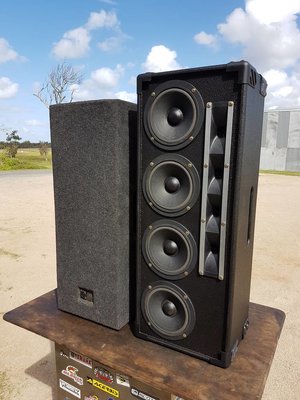

Managed to finish the SLAs, after EQing the 10k craziness they sound delightful. The alloy strip will be changed to bronze anodised soon, the alloy is a touch too shiny. The overall size came to 31.5 x 12'', the main brace moved back and baffle moved forward 0.5'' to have what I felt enough meat in the baffle for the drivers.
I went with four 1016s because I'd built a set with six before (with illegal drivers supplied to me by a friend) and they were too bright, I'm guessing the eminence just have more grunt. And continuously arrayed them so I can't be called lazy!

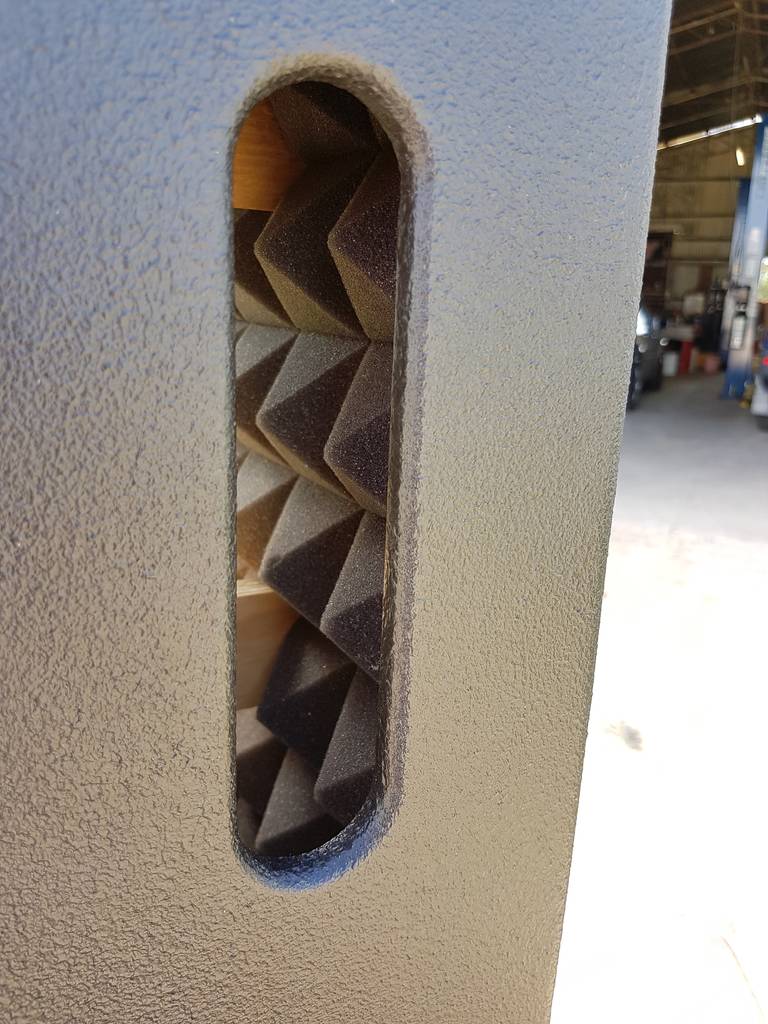

The sound foam is from Clark Rubber, looks nice hiding in there, easier to clean too! Next time I'll spray can black the interior, before the foam goes in.
The pic shows size difference to a regular SLA.
Starting on the TLA Pros now.

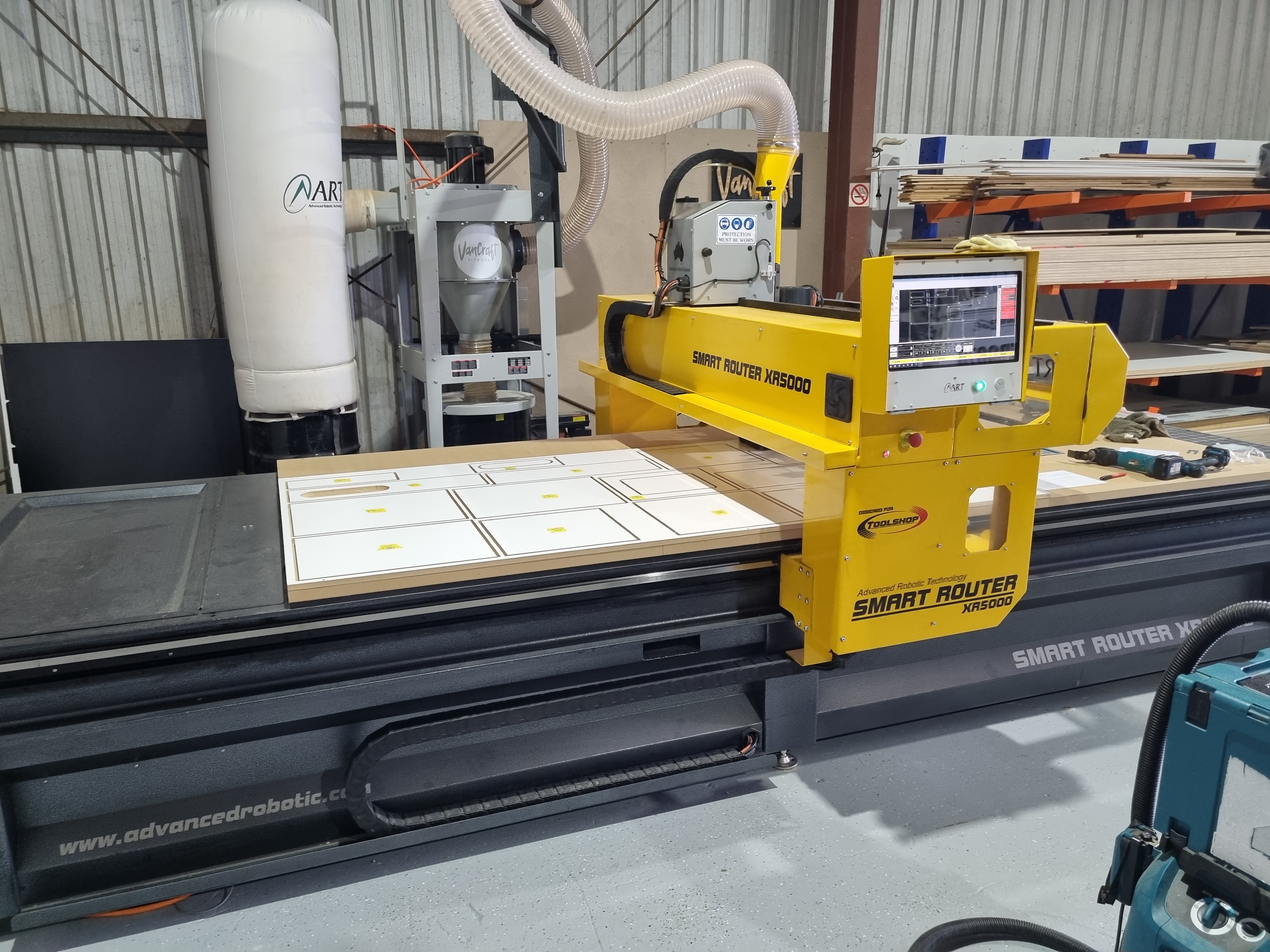

I didn't know where to put this in the forum... so I walked into a customers workshop 2km from my house where he fits out campervans, and was stopped in my tracks when I saw this...
Pretty sure I had goosebumps

Well, it is in Australia, so this is good!
What a great find, near to you, if you ever decide to go that way...
