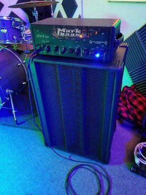

I'll be putting up a pic spread of the entire build on this thread some time tomorrow. The one I posted is the finished product. Tonight will be its first time out at a gig.

So... the cab was used in its first gig last night. This thing is un-freakin-believable! The immediacy, and the way it cuts through the mix is insane. The impact , and presence is something else. I still can't get over what comes out of it.
Posts: 26459
Re: Jack 210 build. WOW!
#7 Post by Bill Fitzmaurice » Sun Mar 04, 2018 9:08 am
The vertical dispersion of the tweeter array is very tight, so you should tilt the cab back so you can hear them as well as the audience does.

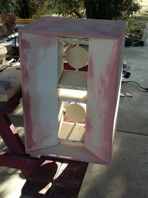

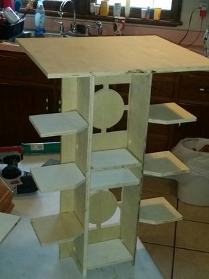

#9 Post by SammyTheBull » Sun Mar 04, 2018 6:00 pm

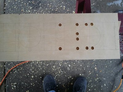

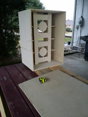

Finally got the chance to post some of the build progress pics.
