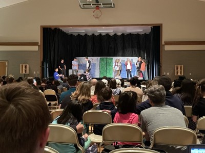

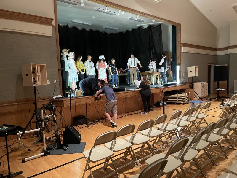

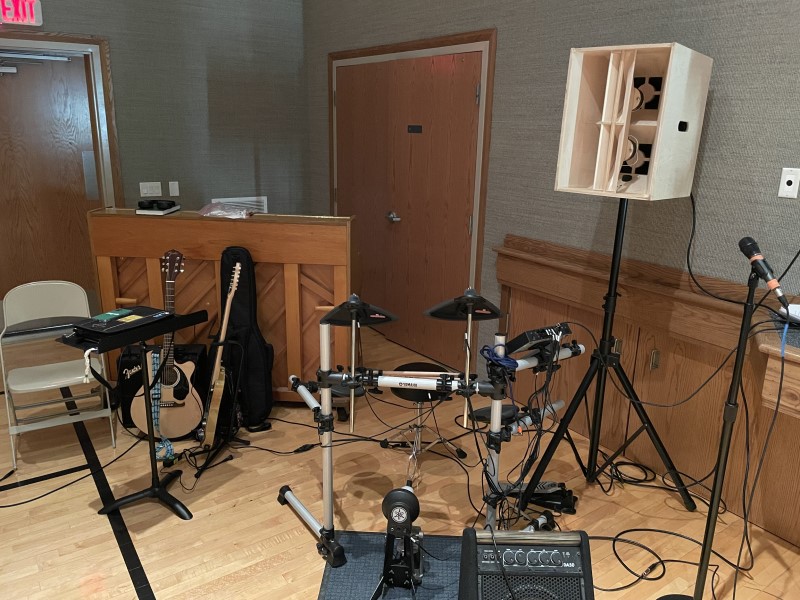

Not the best set up, but it worked...
Practice, and you can see both OTops with the T39s on the far end of the stage.

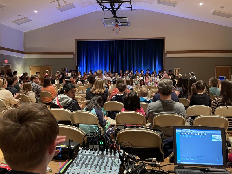

One of the youth running front of house... with a watchful eye :wink:

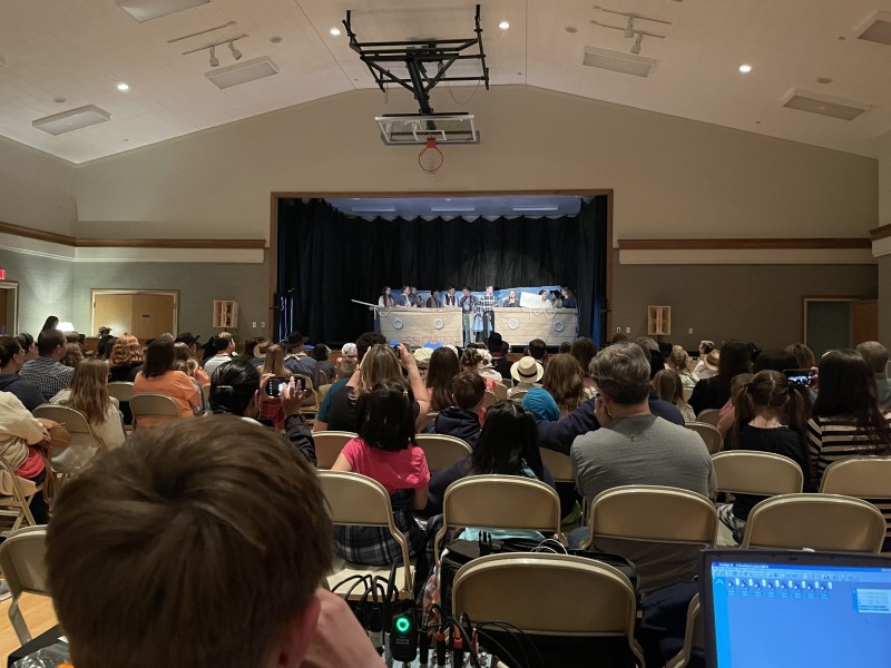

SHOWTIME

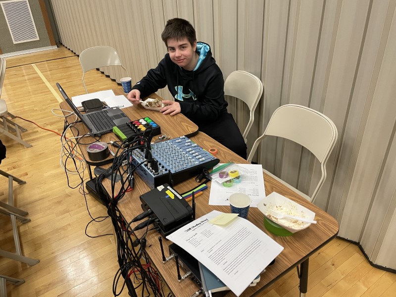

Son, are you really eating next to the board ?! (he was careful, and more importantly i got him away from video games. He did help with the build as well)

J_Dunavin wrote: Sun Apr 24, 2022 12:03 am Son, are you really eating next to the board ?! (he was careful, and more importantly i got him away from video games. He did help with the build as well)
Evidence suggests that Dad set the example and has been eating right in front of the board :cop:
Nice job, good to trust the youngsters with their share of the work. Well done :clap: and thank you for sharing.

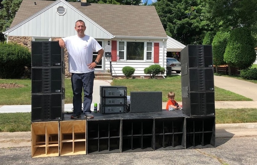

Of course I forgot to snag a picture, but I ran this setup outside today, same location as you can see with the previous set up.
The OTop8 and T39 combo sounded great outdoors as well! The sound carried really well sounded crystal clear.
I will say that the OT8s did outrun the T39s though, which were V plated on the ground, no boundary loading.
In this case I could of used another set of 39s, but that's just a little beyond the scope of what I am trying to achieve with this much smaller set up. It's no six DR200 kind of thing, but it sure does sound nice.
Even had a couple of neighbors compliment on the setup.
After we rocked out on the corner for a while we moved just one top and one 39 to the back yard, loaded the 39 up against the house and it also sounded fantastic. If anyone was looking for a simple back yard party set up, i can't see how you could go wrong with one of each.
