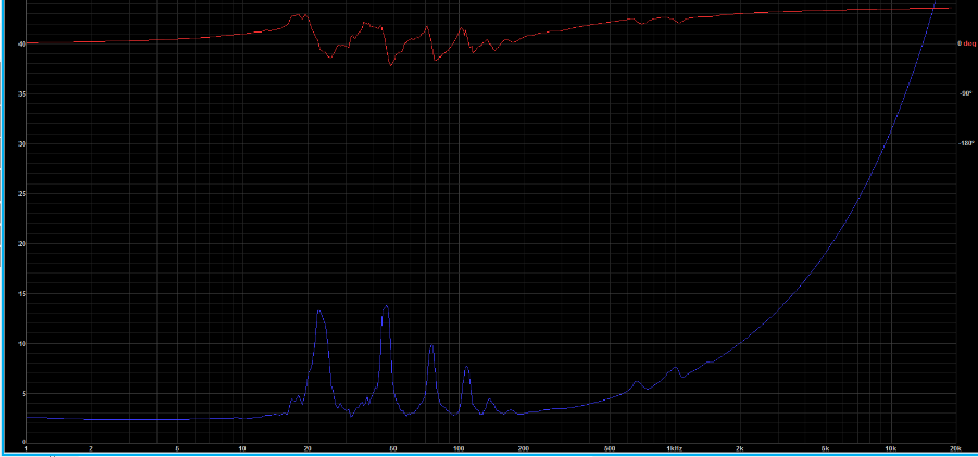

Maybe a picture will help, here is an impedance measurement of my dual Lab12 T60's wired parallel:
Ohms on the left vertical axis, frequency on the horizontal labeled on bottom, impedance plot in blue. You can see how impedance varies wildly with frequency, what you would say is "Nominal" is up to the designer I guess.
http://i769.photobucket.com/albums/xx3 ... g~original

You're awesome! I bet that would help. You don't happen to have a larger, more legible version of your measurements available would you? I see the lines, but can't make out any of the numbers.

It worked on my end but I was logged in to image shack at the time, try this one:
You will have to hit the + sign in the magnifying glass mid top right to enlarge.
http://i769.photobucket.com/albums/xx3 ... ot%205.png
Edit , I tried it on my phone and no suck luck,
Try this one, lower resolution but still legible on my end:

Yeah, later last night I looked at it again. I blew it up real big, squinted, turned my head from side to side, thought real hard, and deduced some figures with my questionable logic. Darnit if photo bucket isn't pushing themselves out of business. Hahaha
Anyway, I'm quite surprised to see the troughs within the bandpass right there at 3 Ohms. Not what I expected to see. Thanks for that bit of visual aid. It's much appreciated.
