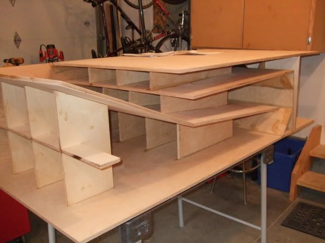

After buying the drivers a year ago, I finally had the chance to begin my dual 36" THT-LP build...
The wood: 4X8 Baltic birch
Rift Cut Red Oak veneer:
Moral support...
Where I could, I doubled-up on the cuts to save time for the next build.
36 inches is a loooong reach!
When I got to the braces, I decided to stop and make a sled for the table saw. (BFM plans, with red oak backer and "miter sliders" from Lee Valley)
3 braces required for the 36" version

"Production mode"...
Braces...
And the side panel...
Next up: chamber bracing, cover, driver install... test! :D
