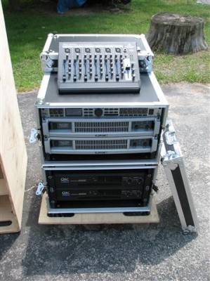

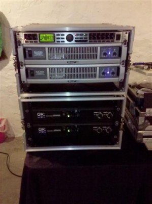

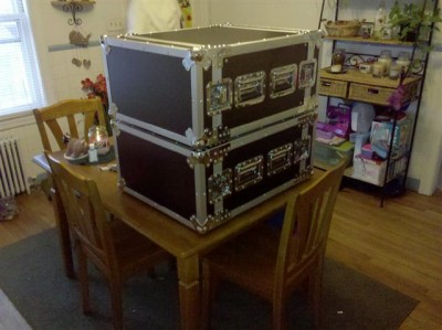

In my BFM rig I'm running 2x racks from audiopile.net. Quality is amazing for the price. Link: http://www.audiopile.net/products/Cases ... page.shtml
Top rack: 2x PLX's w/ DCX2496, this is setup so I can use just this rack for up to 4x OT12's, and 4x T48's. Add the..
Bottom rack: 2x RMX's, now I can run up to 8x OT12's and 8x T48's.

Same rack I use
Love it. I wish the powerlights arnt as deep as they are.

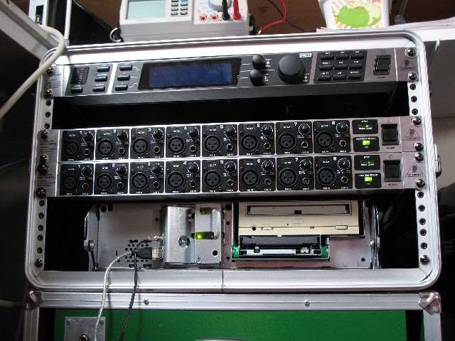

Mixer: 6 space rack with stripped down Dell office PC, hosting SAC. 2x ADA8000 and DEQ2496, 16 channels in and out.

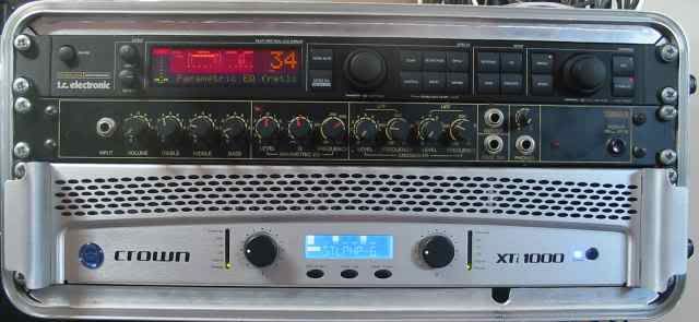

Amp: Xti1000 in a separate 4 space rack. It does double duty, included is a 1u preamp so it can also power my bass rig. I'd like to add one or two more power amps, funds are scarce though at this time.

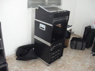

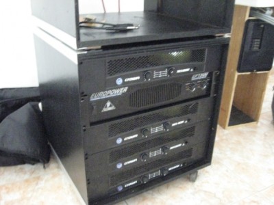

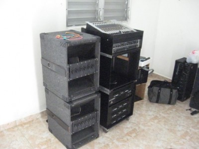

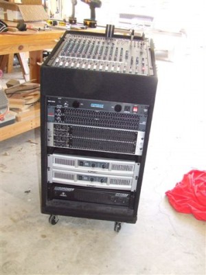

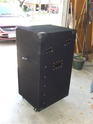

This is mine guys
it is a 3 piece rack with up to 20 spaces plus the mixer it isnt finished jet but it shows almost as it would be
it is driven by behringer and powered by crown

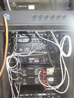

This one is for band use. Everything is connected internally. Power plugs in with a Powercon, add speakers and it's ready to go. Currently though, the amps you see have been replaced with 2-Crown XLS Drivecore. One man can pick this up now to put it in the trailer.

Don't know you already aware of this, but the xls's and the ep don't play well together. The air flow is reversed, so if you have reversed those fans in the behringer, you're just creating a loop of hot air in that rack. It's like mixing qsc and crown amps; they're reversed.Israel wrote:This is mine guys
Re: How are your racks setup?
Thanks Seis Ive that covered I reversed the behringer fan they all throw in the same direction... it was supposed to replace that behringer but i love that knockoff it have been with me in the lesser days I do not have heart to trow it in a cornerSeisTres wrote:
I Grab the sale on those crowns they are way too cheap to let them pass .....yess they are heavy but not as heavy (the behringer is 10 pounds heavier than the 402 which have about the same amount of juice
