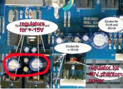

Here's the relevant bit of the ADA8000 power supply. The large capacitors are too small, the regulators run hot.

So are you saying that the caps I circled are the ones that would need to be replaced?

I think so. They need to become larger capacity, that will not fit the original board. The author of the article added a small separate board with the larger capacitors, and a separate regulator to make 12V for the fan. Here's the completed mod on an ADA8000:
Left: small fan added. Just below that: caps removed, wires to new cap board installed (red/blue/black).
Right: the new board, installed upside down (don't know why)
Top: some foam on the cover to prevent the new board from shorting when the cover is installed
