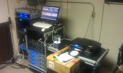

I replaced my whole rig (and the one at church) with these. All total I have 10 of them (6 1600s and 4 3000s). Nice and quiet, good power. The 1600 will not do 60v, though. For T39 3012 or Lab, I'd get the 3000... it tops out just below 60v in my tests.
