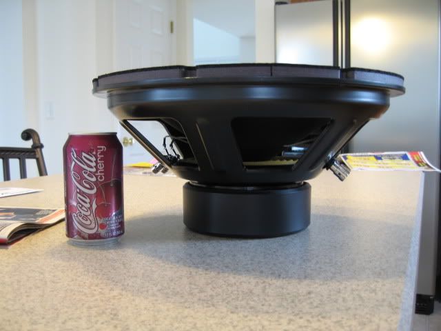

So today the Dayton DVC 15 arrived along with some speaker gasket tape which will be used for the access panel and a terminal cup for the speaker leads.
The driver is alot bigger than I expected. The pictures I've seen don't give it justice. Not as large as my Mach5Audio 18, but pretty hefty none the less. Good bang for the buck I think

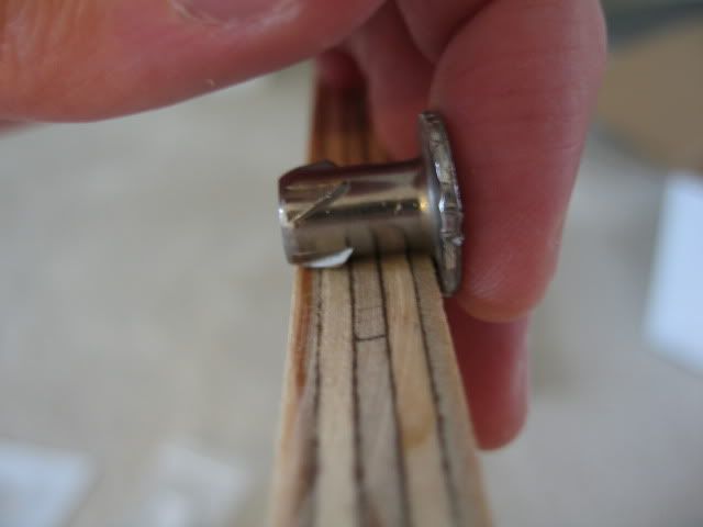

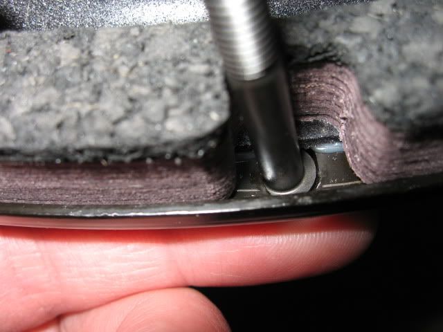

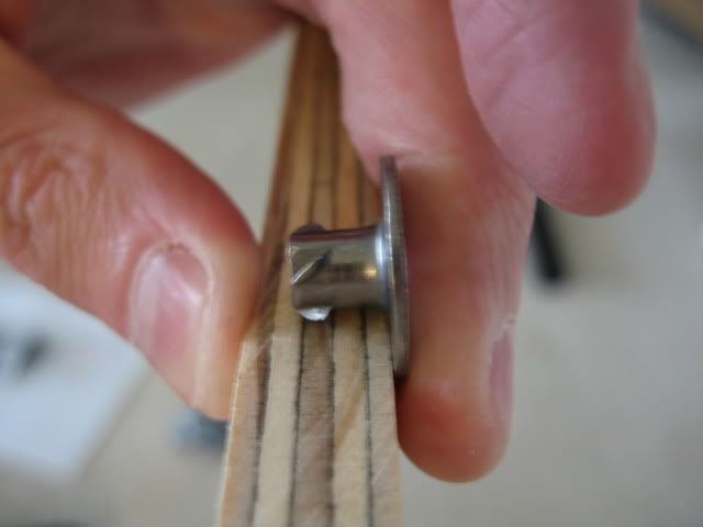

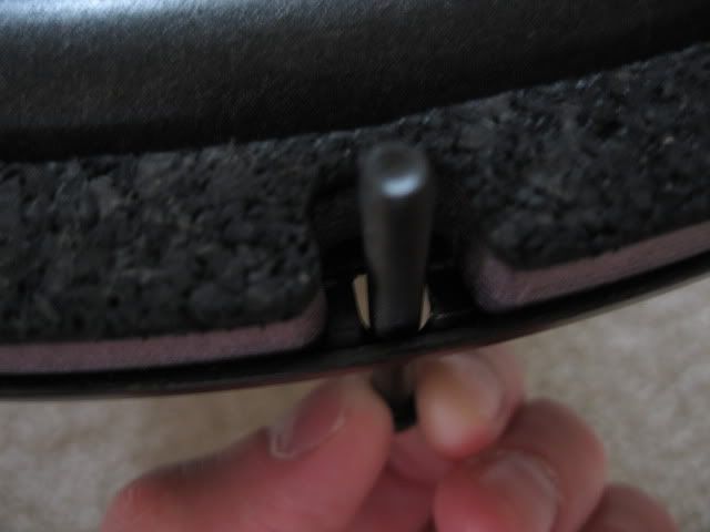

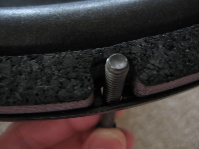

I also have a little contention here regarding the choice of socket cap bolts and hurricane nuts.
* The 1/4-20's fit better but the 1/4-20 hurricane nuts are longer (a tiny bit longer than the width of the 1/2" ply)
* The 10-32's are very loose with the head of the socket cap almost looking like it could slip through given enough force but the 10-32 hurricane nuts are shorter but the base is wider.
thoughts?
(10-32 on the left, 1/4-20 on the right)
1/4-20 hurricane nut profile in 1/2" Arauco ply
10-32 hurricane nut profile in 1/2" Arauco ply
1/4-20 socket cap (note nice fit)
10-32 socket cap (note loose fit)
10-32 hurricane nut top profile to give perspective of how wide it is and clearance needed
Also, incase anyone ever had doubts that this wasn't made in the same factory as the Adire Audio Tempest, Here is some pretty good proof: "Made In USA By Eminence" sticker on the backside of the frame:
Nice Gasket raised 3/4" from base of frame allowing XMAX and a nice seal rear mounted to speaker baffle:
Dayton DVC 15 Profile:
Here is a similar pic of my Mach5Audio IXL18 in my LLT (Unfortunately Bill doesn't allow images greater than 700px) so I can't inline "[img]" this:
http://www.derekreynolds.com/gallery/al ... G_2497.jpg
In family room testing driver, LLT in background (note when testing I made sure rear pole vent was not covered):

#10 washer, (technically a #10 rivet burr), #10 internal lockwasher and you'll be fine. The 1/4's will work fine also. The new gasket from Eminence does not compress fully, allowing some room for the excess nut. Your placement will have to be spot on so it does not hit the frame. That's why the 1/4's are only with the clamp mounts in my kits. Lessons learned the hard way.

A slightly smaller bolt diameter isn't a worry, because it allows for small errors in hole placement.
A 10-32 bolt will pull a pickup truck, so I doubt it will have problem holding down a 15" driver.

Regarding the usage of a #10 washer, as I understand it would be placed in between the bolt head and Subwoofer frame?
10-32 Bolt --> #10 internal lock washer --> Subwoofer Frame --> Plywood --> 10-32 hurricane nut
This what I want?
Wed Jun 17, 2009 10:14 am
Profile
Posts: 4641
Post Re: myn's Tuba HT Build Thread
Yes
