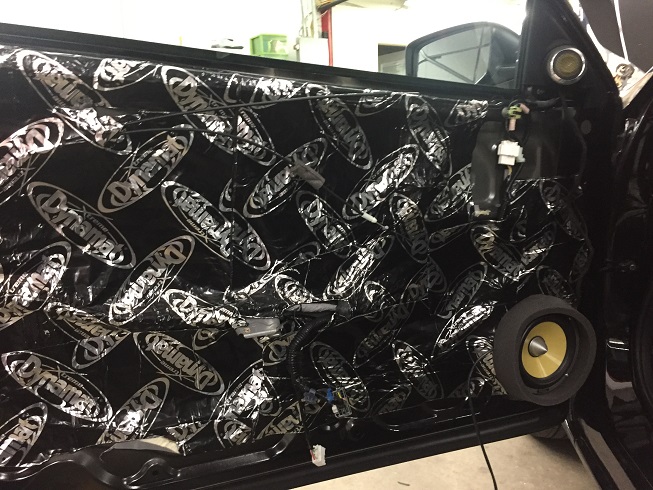

Visited the installer yesterday to take some shots "in process". He had dynamatted the whole trunk including the lid and put it back together. No use taking any photos of that. I did get these of Ms. AT's new playmates however...
