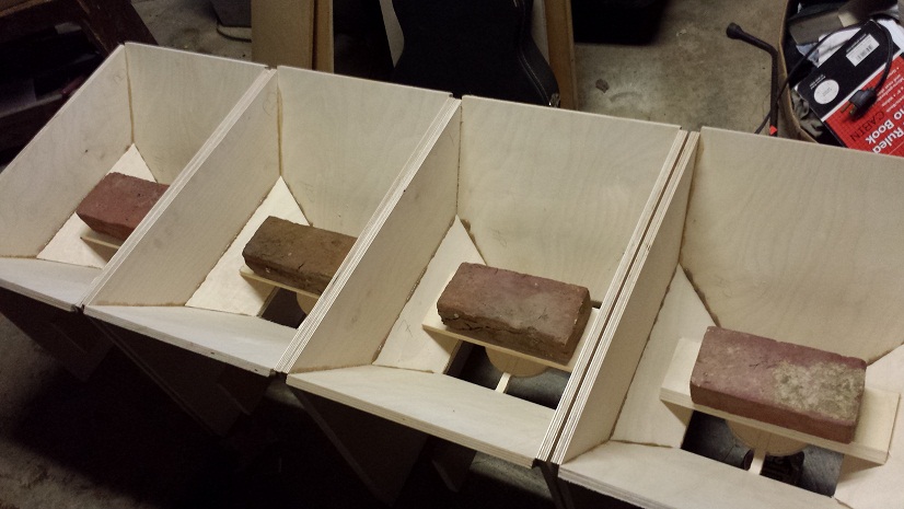

Putting the shells together. I deviated from the plans again.... But a big "thanks!" to whomever invented those W clamp thingies!

Re: Another OT12 build
Bruce Welby posted a few times about them.But a big "thanks!" to whomever invented those W clamp thingies!
- Posts: 8301
Tom Smit wrote:Bruce Welby posted a few times about them.But a big "thanks!" to whomever invented those W clamp thingies!
Just something I found in an old woodworking magazine......I've used 'em for tons of stuff outside of speaker building over the years.

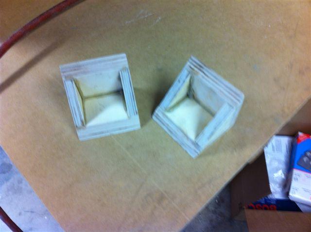

Small progress today - got eight throat reflectors cut out, with their angle cuts. The long side 45 degree cuts were easy, then I used this makeshift sled on the small tablesaw for the other cuts. First one side:
Then I rotated the sled over to the other side of the blade, flipped the piece over, and did the second side:
I don't think I have the energy to actually glue them tonight, though...
http://billfitzmaurice.info/forum/downl ... &mode=view
I've found this to be the best and easiest way to clamp those buggers.....
Thanks David, that's easier than what I was going to try! Makes perfect sense!

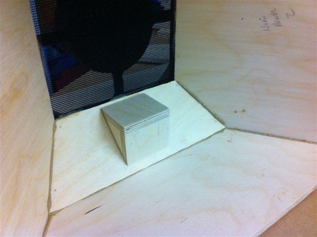

Throat reflectors installed, lots of excess PL trimmed (tedious), and holes cut for top hats. I clamped my little "portable drill press" to the cab and used a 1 9/16" Forstner bit. This way the holes line up just right.
The top hats (the steel Penn-Elcom ones that Leland sells) are a very snug fit. I won't need to use any sealant here.
On the very last one, however, the final layer of ply gave way and separated completely. I'll have to patch that up. I suppose I should have used a sacrificial backer board...
ctmullins wrote:Throat reflectors installed, lots of excess PL trimmed (tedious), and holes cut for top hats. I clamped my little "portable drill press" to the cab and used a 1 9/16" Forstner bit. This way the holes line up just right.
Just put a doghouse on all of 'em....you have to seal 'em anyway....
You know, I need to understand this part of the design a little better.Bruce Weldy wrote: Just put a doghouse on all of 'em....you have to seal 'em anyway....
Unlike the Jacks, the space under the throat reflectors is completely isolated from the main chamber. This means that it must not play a part in cabinet tuning, other than serving as part of the horn path.
So why exactly does it need to be sealed off?

- Posts: 8301
ctmullins wrote:You know, I need to understand this part of the design a little better.Bruce Weldy wrote: Just put a doghouse on all of 'em....you have to seal 'em anyway....
Well, you made me do some research. I built mine under an older set of plans where the baffle had slots in the top and bottom - only the baffle for the 3012HO was solid. Looks like the newest plans don't show a different baffle for the 3012HO and the other drivers as far as the slots.
I guess you don't need to seal 'em.
Mea Culpa....
Yep, they disappeared in the 2011 set of the plans and aren't present in the JArray version either.Bruce Weldy wrote:Looks like the newest plans don't show a different baffle for the 3012HO and the other drivers as far as the slots.
