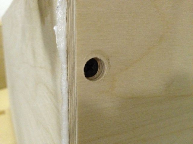

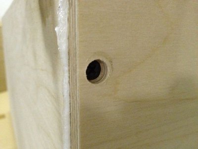

Finally everything has arrived, got the plywood mostly pre-cut and the drivers arrived today. It's probably gonna take a while before I really start building, being rather busy and going on a vacation soon, but I've made my first panel joint yesterday. Just couldn't wait.

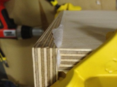

Tried the Rectavit PU glue I found where I bought the plywood. Here are my first pics.
Should I use more glue? It seems OK to me...
Posts: 7707
Re: Omni 15 Tallboy - my first build
#2 Post by Tom Smit »

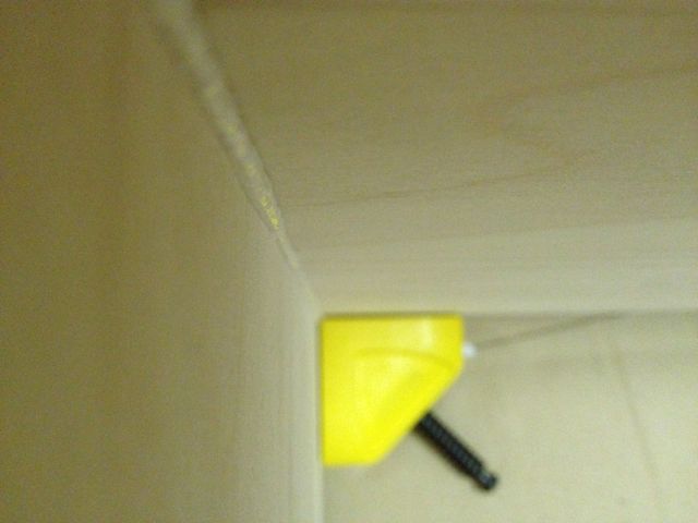

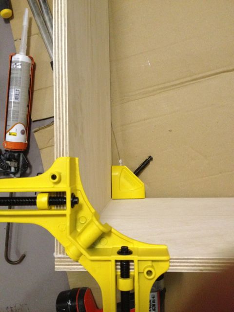

Looks good, so far. You have nice squeeze-out. How is that one corner clamp held in place? Does the adhesive hold onto it?
PulseMan
Posts: 147
Joined: Tue Jun 03, 2008 1:43 am
Location: South Africa
#3 Post by PulseMan »
Tom Smit wrote:How is that one corner clamp held in place?
Tom, that is the back side of the clamp, same as the front one. :wink:

They are two different clamps, the one at the far end touches the adhesive. So... wax paper is needed.
Edit: There was some glue on it but I had no problem removing it from the panels

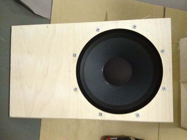

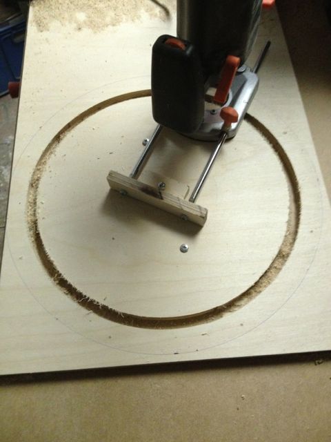

Couldn't stay away from it, this is too much fun... and I was granted some unexpected free time.

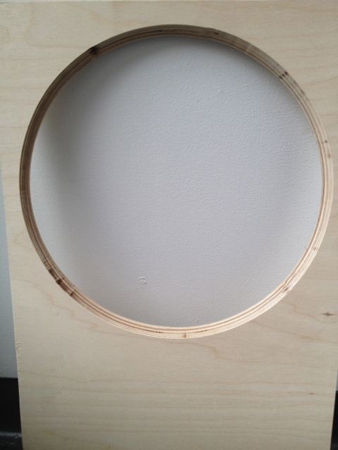

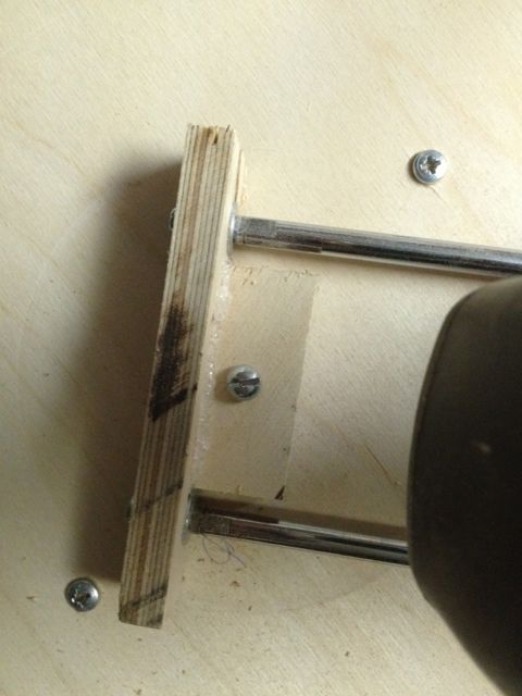

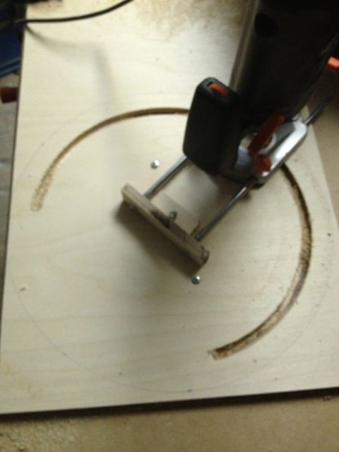

Front and side panel are in place, and I even started out on the baffle. This seemed the hardest part to me, but turned out rather well, thanks to having read other build threads.
I cut the baffle hole with a router (Thanks AntonZ!) a bit too small and then cut a 45° angle on the driver side to make it match the driver specifications.
Rickyvt
Posts: 144
Joined: Tue Jun 19, 2012 5:11 am
Location: Antwerp, Belgium
#9 Post by Rickyvt »
It fits!
