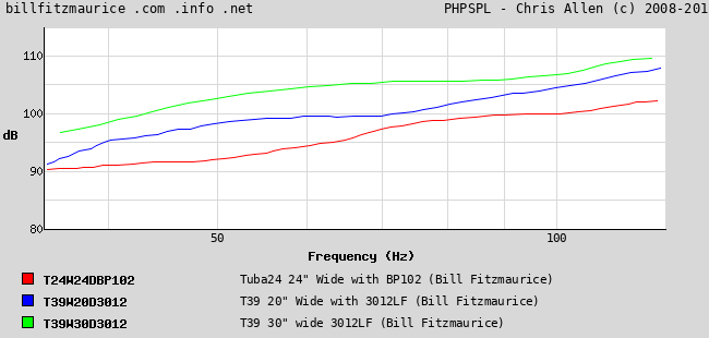

Your 1st problems are the height of the SLA and the 30' high ceilings. The bottom driver of the SLA Pro should be around ear height of a standing person, so I would put the bottom of the cab around 60" or so. 2 of any sub would not cut it in a room of that size. Think of it as trying to provide sound to a "normal" room that is over 3X the size of the one you were in.
IIRC, you have 1 pair of OTop 112s. Add at least a 2nd pair. I don't know why you are so insistent on using compression horns, but to each his own. However, stop thinking you need 2x12s! Build singles. This makes your system way more modular, like making spiral arrays for outdoor, "super-wide" dispersion. But, I would HIGHLY recommend that you build the OTop 12 J-Array singles from here on out, to add on to your currents. Forget about the Jacks. They are an "all-in-one" design. You will always use subs, so Jack 12s are not as good of a choice as OTop 12s, in your situation. Keep the SLAs around, they will be handy when you do small, house/backyard parties.
As for subs, T39 absolutely beat the shit out of T24s. They are a little larger to transport and store, but a pair of single 3012LF loaded T39s will beat the snot out of your dual BP102-loaded T24s, SOUNDLY. Make your 1st pair maybe 20"-24" wide, make your 2nd and subsequent pairs 28"-30" wide, for maximum SPL per cab.
