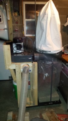

Here is the final assembly, just whacked together last night and tested. I bought a DWV to 4" hose connector, 10 feet of hose to go to my various tools, and a 4" to 2.5" adapter for some smaller tools or shop vac accessories, as this baby will be used to vacuum the floor too. You might also notice the 2 for $5 pavers I had to buy for ballast. Dang if I didn't move the center of gravity something awful with all my ACME bolt on accessories. I had seen a few designs where they inverted the legs and mounted to a garage ceiling, then bolted the blower to a wall. Now I know why, this thing is a bit top heavy. The two pavers brought it right back down though, and it rolls around the shop nice and smooth without being tippy at all.

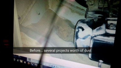

Now for some before and after test shots. I have a video as well, not sure how to post or host that yet.
My Jet SuperSaw full of sawdust from a bit of neglect:

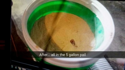

I apologize in advance for the next two crappy pictures. My cellphone apparently eats photos, so I had to snag these from the video playing on another PC.
The 5 gallon pail is nearly full of sawdust after emptying several months of project dust from the table saw!

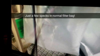

And the resultant proof, the original HF cyclones dust bag is empty. There are a few specs of sawdust in it, but at this rate, I'm guessing i'll empty a pound of dust out of it every year or two. Again, crappy screen capture, i'll get the video up somewhere.
