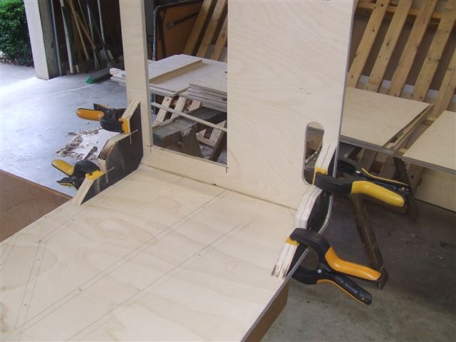

Rune Bivrin wrote: Now, can someone tell me what the heck a cawl is?
It's a caul. A brace or support used to hold or align wood.

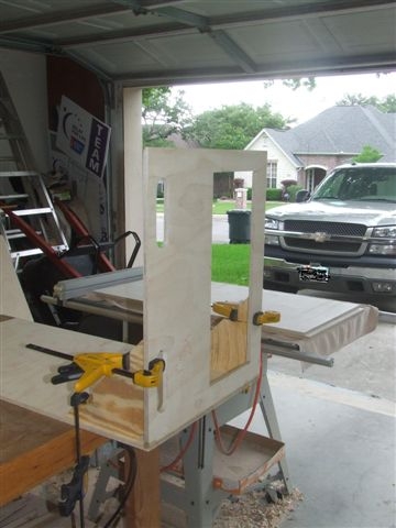

For example....these are probably best described as braces, some have called them cauls....

The typical caul in woodworking is a board that has a slight bend to hold down the middle of a long reach by clamping the board across a long stretch - the bend is placed down so that it creates pressure in the middle.
But, I've heard the term applied to any piece of wood that's used to hold something in place....but that's not as accurate.
