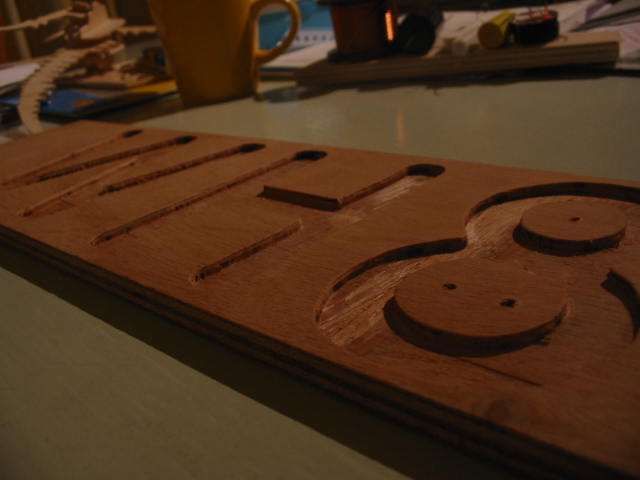

I have always been impressed by the routered logo's/names on the sides of cabs. Makes them look less DIY, more professional. So I took some scrap ply, printed super large font WH8 on some paper, stuck it to the ply with glue and hit it with the jig saw. Of course I forgot to take the width of the router bit and pattern follow ring into account, so I had to use the center parts as well to not make a proper mess of the "8".
Then try the template on another piece of scrap ply. The shape is not bad, much better than I had expected. But I routed way too deep.

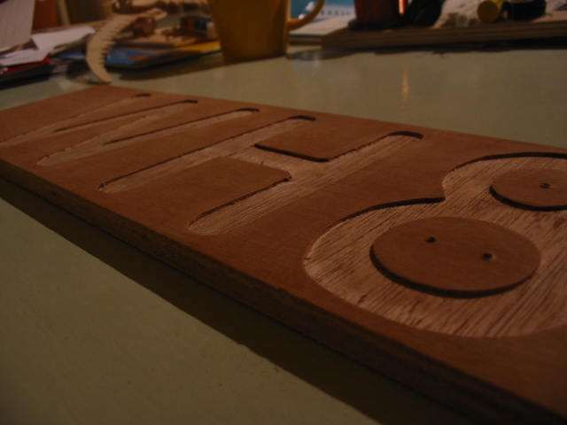

Changed depth to approximately 1 mm (a tad under 1/16" if your mind is not metric). It looks much better at this depth.
