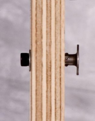

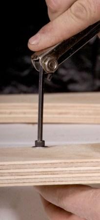

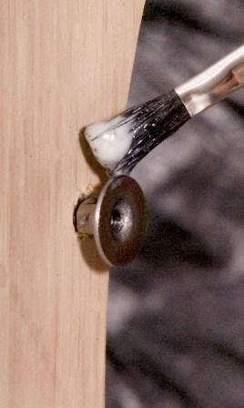

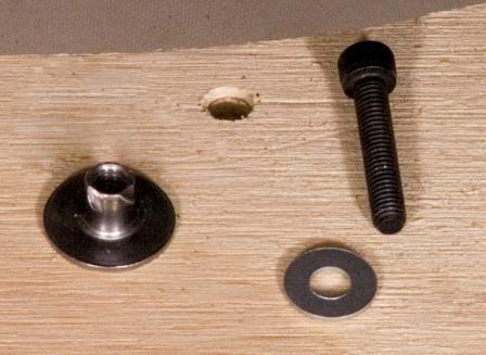

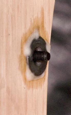

10/32 hurricanes require a 1/4 hole. Epoxy on the barrel as you pull them into the wood. The flutes will hold by themselves, but if you get overzealous with the bolt you can spin them. The epoxy cures that. It's a little heavy in the last pic, but I really wanted it to show up. It also shows how far in to pull a hurricane.

Thanks for the pics. Your washer is a normal one, but I need a lock washer right?

The washer shown was for spreading the load when pulling in the H-nut, otherwise the bolt would pull into/through the wood. Oooo, that wouldn't be good!.bean438 wrote: Your washer is a normal one, but I need a lock washer right?
When installing the driver, use a star washer under the bolt head to lock bolt in place; it's better than a lock washer.
