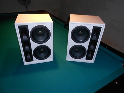

So if you read my thread about building my THT then you know everyone flocks to my basement to sponge the alcohol and party it up. Well the THT was a success with heavy dubstep, hiphope and some alternative. New problem came up as a result. My little bookshelf Boston Acoustics couldn't keep up, so I shot over to speakerhardware.com and ordered up the SLA Pro kit and split it in half like I seen others do here in other posts. I figured two full size SLA pros would be way over kill for my basement. I just want to say to anyone in the same type situation like me that has more of a party atmosphere in the basement, the half SLA Pros are the way to go. They sound fantastic and get plenty loud with little power. Heres a picture. I like them in white like I seen in another thread here, so thats how I did mine. I still need to find the steel mesh grills for them so no moron that comes over fingers my speakers!! ha

Looks great.
I'm in the middle of making a pair of mini's for a practice PA for my garage.
Where did you put the port,back or side?

I put the port in the back, center. Right behind the brace. I also mounted the crossovers to the brace so i could have access to them through the port hole. I'm at work now but I'll post up a pic tonight.

Did you find dampning a problem with the limited space through the speaker cutouts and behind the main brace.

Directly behind the drivers on the brace I used this http://www.parts-express.com/pe/showdet ... er=260-516 . I had to trim it down a bit so it wouldn't touch the drivers. I also used that on the top and bottom panel. I did have to fold the pieces in half when sticking them through the speaker cutouts. Other than that it wasn't an issue. Behind the brace on the top and bottom I just stuffed some poly fill. Directly behind the brace, however where I mounted the crossovers and the port is I didn't put anything. They sound really nice as long as you don't expect them to play down to low past 100hz. I think if I remember reading other post here that even the full size don't get to low. Honestly they sound fantastic. They really stand out with things like a snare drum. I was just listing to a drum solo by Travis barker and paired with the THT and these little guys, I was getting goose bumps. My little boston acoustics 'NEVER' sounded like these.. :loler:

Did you use 2x8 ohm speakers in parallel for 4 ohm load or 2x4 ohm in series

I did 2x8 ohm speakers in parallel for 4 ohm load

Im starting to build a TT soonish and these would compliment it perfectly for music.. Did you use the "3.5k Piezo Array High Pass Filter" from speaker hardware?

Phaedras wrote:Did you use the "3.5k Piezo Array High Pass Filter" from speaker hardware?
Yes, thats the exact crossovers I used. I'm thinking of making another pair but this time I'm going to use ribbon tweeters

Cool.. Did you change the size of the ports in any way? Im thinking it needs to be of a different size than the full sized SLA Pro..
