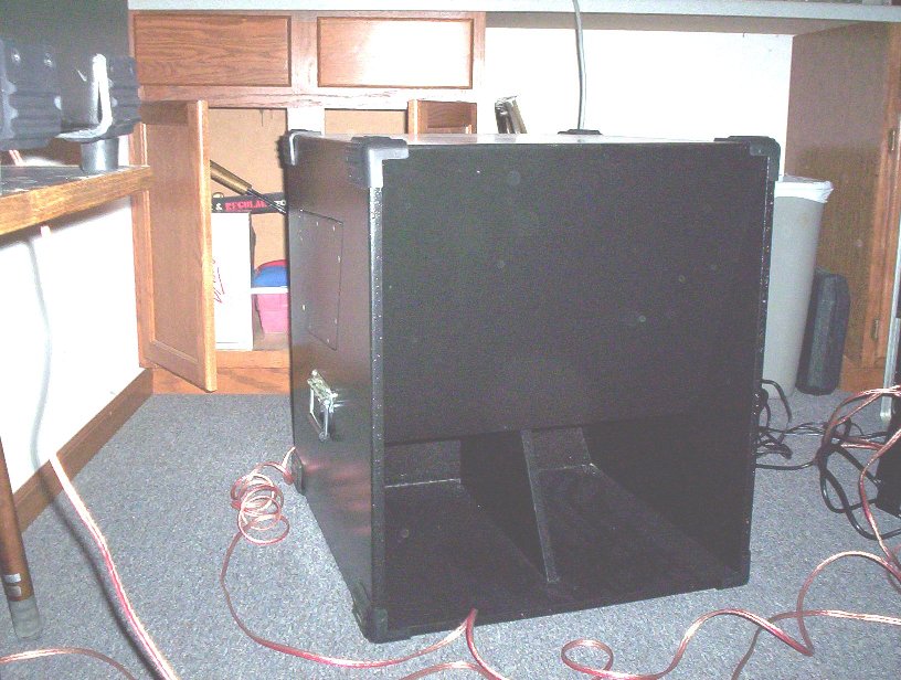

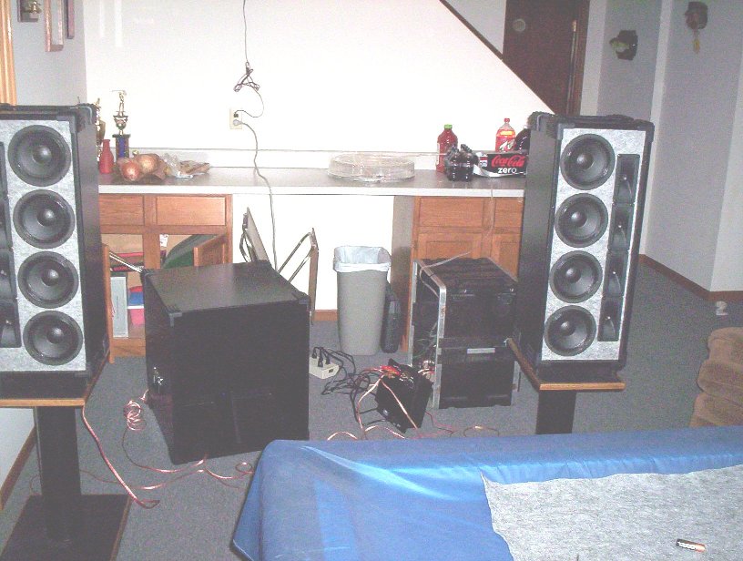

I guess they're finally done. Started back in Feb. Took some time off between the T24 and SLA. The T24 is 20" wide using recomended driver. The SLA Pro is using the Dayton 6" as I was able to buy all 8 for $100 plus shipping thanks to Mikey on this site. There is a single port on the back, xover attached to the back of the middle brace that has access through the port. For some reason the left seems to sound better than the right but all the wiring seems to be correct. The Pros and the T24 seem to match up really well. Using the Daytons I think a sub is mandatory with the SLA pro as the bass is weak sounding. The electronic are far from ideal but using the plate amp high level inputs cross at 125hz. Hope to get better amp eventually. Use will be recreational parties just for fun, non-commercial for now anyway.
I thought I did all 3 for around $300 until wife handed me a pile of lowes/home depot receipts, so I guess it was closer to $400 plus $100 for the plate amp. Overall sound is pretty impressive, especially the T24. Can't wait to take outside and crank it up a bit. Thanks to all on this site that provided help.

Are the SLA Pros still getting closer in sound?
Re: Finished SLA pro and Tuba 24 pics
Thanks. The plans mentioned carpet could be used as a gasket and I liked the contrast in colors so I painted black and only carpeted the front. For paint I used 3 coats of "painters touch" that was $9 a quart. I sealed the cabinets with 2 coats of urethane and 1 primer sanding between coats.
It think they sound closer. Going to play them for a few more hours and get somebody to listen before I start taking apart. I'm almost positive the wiring is correct. If anything it is probably a flaky driver or connection.
