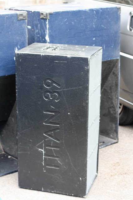

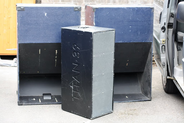

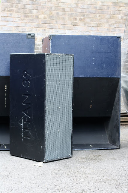

I went to collect the speakers tonight with the intention of taking them out of service. The new van is capable of fitting both of them in, but they are still massive. I took them out of the van an took a shot with them next to one of my 16" T39.
The cabs were beat. Lots of deep scratches, battle scars and damaged corners. These cabs had been well used.
Fitted with wheels and hole handles, they were still a bit cumbersome for the venues of the UK, so my decision to retire them had not changed.

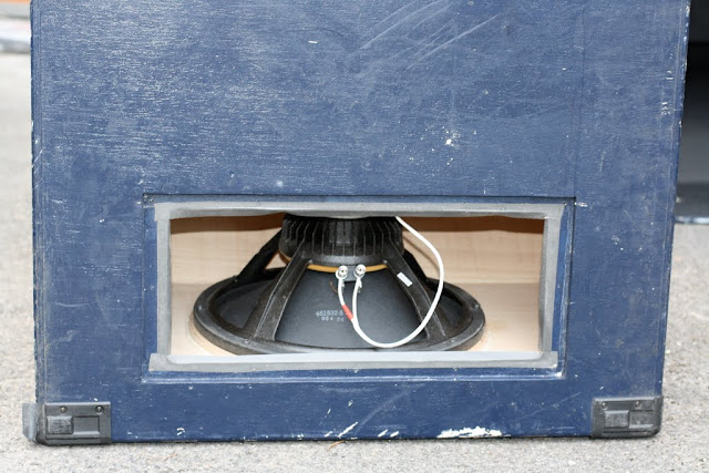

Removing the driver cover showed an absolutely pristine 3015LF driver - It looks like it has never been used.
The smell of ply that came out of the void brought back memories of the original build. In unscrewing the driver I found the bolts to be quite loose. Used with T-Nuts and no glue, they had obviously worked themselves out a little during their time in service. Given that it only took a couple of minutes to remove the cover, it is probably good preventative maintenance to check these every quarter.

Dave, they are mashed! They need new corners, new paint, more bracing on the back (due to a vibration issue) and new mouth bracing.
But if you want them, you can have them. Free of charge. I was just going to take them to the tip, they aren't a very good build.

wow, those realy are huge, they dwarf the T39s! :lol:
i PM'd you incase things fall through with dave.
id love to AB these with my T30's, i bet they would destroy them though! :twisted:

The mouth bracing snapped off - A warning to those who use laminated ply!

I remember reading about it a while ago but Chris can you tell us again what you used to cut the "Titan 39" into the side?
Obviously a router but what sort of template?
Zack Brock
Re: 30" T48s retired after 2 years hard service
#15 Post by Chris_Allen »
Created the text in CAD and printed (thanks Mr. Perry), drew that onto to a piece of ply and jigsawed. Screwed the ply down and routed.
